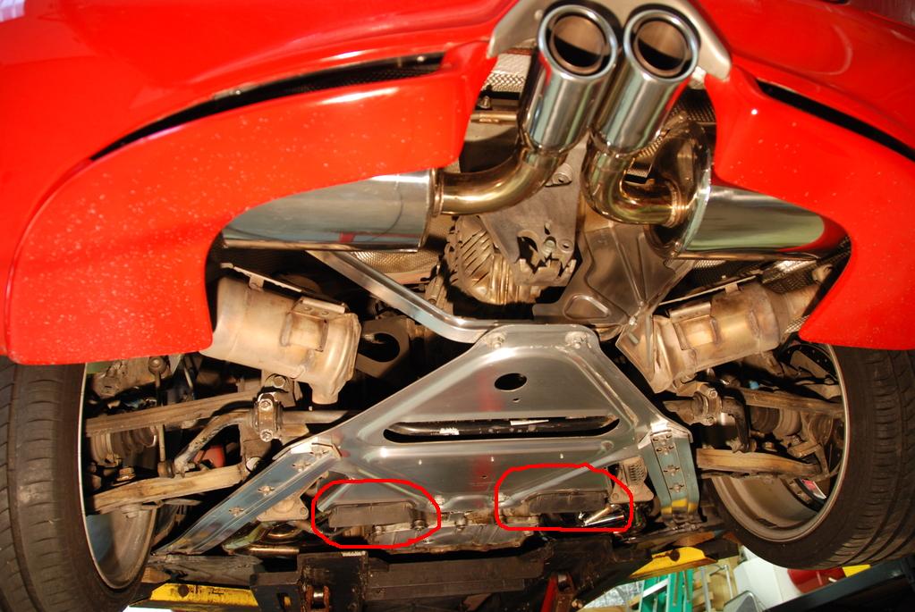

I'm looking for the part number for the rear axle cooling scoops on the underside of a Boxster. One scoop sits on each side to help cool each half-axle. I believe this feature was introduced after 1999. Thanks!
Andrew:
The two scoops (which I'm told is for directing air to cool the transmission) are part number 986 331 361 03.
Regards, Maurice.

Maurice,
Thank you so much! Do you happen to know a source for a photo of the part? I want to be sure I'm ordering the correct part and I've been unable to find a pic of it anywhere. None of the diagrams I've seen clearly show what it is I'm looking for.
Andrew
Maurice,
Andrew
Andrew:
Here you go (click on it to blow it up):
Note: If you don't already have them, you will also need two "male and female" plastic buttons. Let me know if you need the part numbers for those, I have them somewhere around here.
Regards, Maurice.

Maurice,
Thank you! Those are the parts I'm looking for. You are a god. Also - Thanks for your offer on the plastic button part numbers. If you can find them without too much trouble, I'd greatly appreciate it.
Andrew

Andrew:
The "push buttons" as Porsche calls them, are part numbers 999.507.774.40 and 999.507.775.40.
You need two of each (two males, two females), which end up as one pair on each side.
If they don't 'click" together when you install them on the scoops, you can use some black urethane adhesive sealant (Permatex makes a good one that is readily available at auto chain stores) to make sure they don't separate. beer.gif
Regards, Maurice.

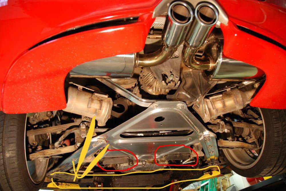

Hi Maurice
quick question what would be the use of the plastic piece makes in yellow? Is it the rear cover? I noticed the part is broken when I did the transmission fluid change the other day. The center part is missing and I only saw two broken plastic parts attached to each side of the screws. Do I need to replace it?
1 hour ago, Pigsypo said:
Hi Maurice
Yes.  Relatively cheap dealer item.
