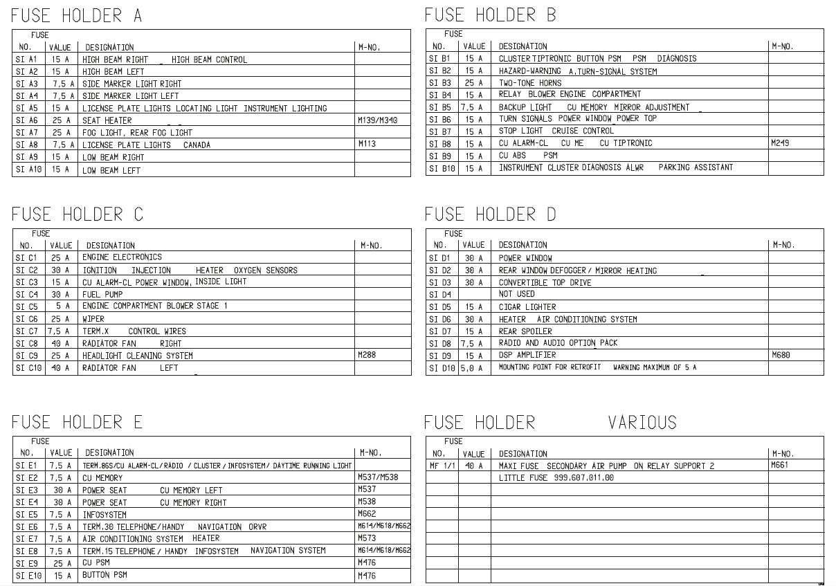

Does anybody have a fuse diagram for a '98 5 speed? I pulled the fuse cover off expecting to find the fuse plan inside, but no joy.
Alternatively, if someone with a similar vehicle wouldn't mind checking to see which fuse controls the lighter, I'd appreciate it. It'll save me the trouble of looking for a blown fuse by checking them all, one at a time.

It is row D number 5, 15 amps.
This diagram is just too blurry to be useful. Can you send me a copy via direct email? bryanhome@verizon.net

If you are looking for MY2004 I uploaded a clear image. Different model years may have different fuse assignments.
I already posted a MY98 as you requested in your original thread.
