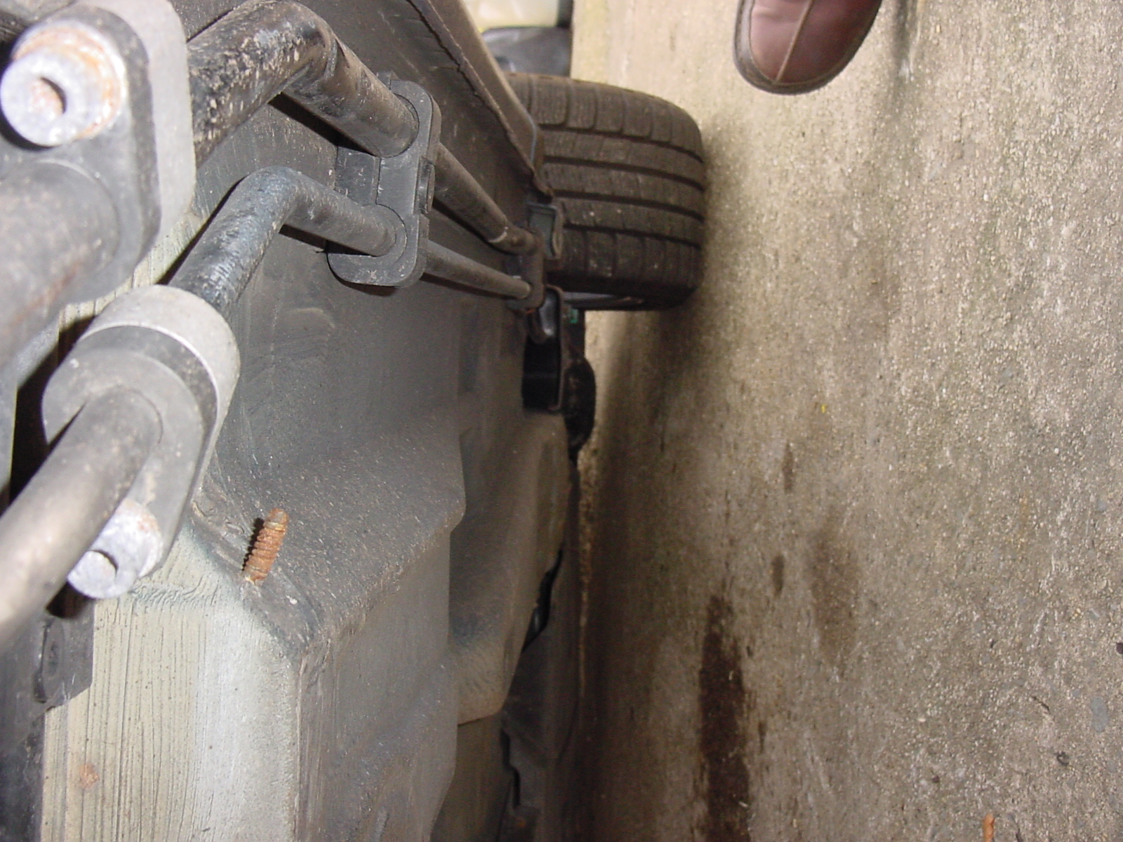

Chris:
There are two fat black plastic lines that run from front to back on the passenger side, just inboard of the rocker panel and it's not that uncommon for a careless mechanic to damage them when jacking up the car from the right front jacking point. They usually just get "smooshed", but in your case there must a crack or break in at least one of the lines.
They only contain refrigerant, so it must have escaped when the line(s) was/were damaged.
One line is the return line and the other is the supply line. The first thing to do is to try to determine if only one of the lines is damaged or if both are damaged/cracked. As long as you are sure that there is no refrigerant under pressure in the lines, you can take a look at the junctions where the lines connect. The A/C compressor is high up on the front of driver side of the engine (just behind the access panel behind the seats), and there are flexible rubber lines that run from the compressor to the black rigid plastic lines.
After you replace the lines, you will have to refill the system but be very sure that there are no leaks at the junctions that you had to undo. Most shops have a device that captures and stores the refrigerant in case of a leak so that it can be refilled after all leaks have been stopped.
Here is a photo of one of the junctions (this one at the rear) where you can disconnect the broken/cracked line:
Here is a close-up of what the ends of the lines look like...Make sure that the areas pointed to by the red and the blue arrows are intact and clean before assembling them (click once on the photo to blow it up):
Keep us posted and maybe take some pics for future posters who run into this problem.
