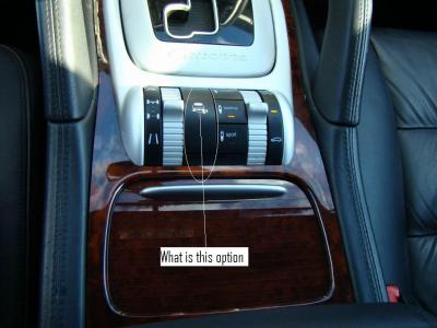

What is this option on my 2005 Cayenne Turbo

On a more serious note .. what wvicary said
As stated dissengage anti roll bars, only works in low range and makes interesting noises when activated. Had it on my last CN, never used it in anger but for serious offroad stuff guess you would need it. It's fully detailed in your handbook how to use it. Whats not in the handbook is the seperate hydraulic system top up point, open your rear hatch and on the left there is an upper plastic trim, lift this off and you have a hydraulic top up point and long dip stick.
Wild guess, but the graphic implies PDCC (Porsche Dynamic Chassis Control), which keeps the car level when cornering etc... BUT, on other cars I have seen "PDCC" explicitly spelled out on the control (though those are all facelift models).
