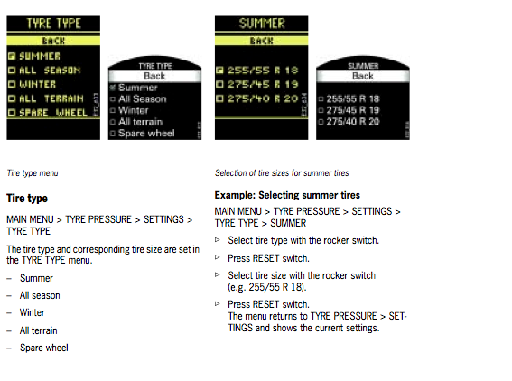

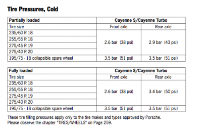

The Porsche spec notes tires as narrow as 235mm acceptable for Cayenne (235/60 R 18).
And you can select your tire set-up via the on-board computer (this may be for tire pressure monitoring option only)
Attached from the '04 owner's manual.
