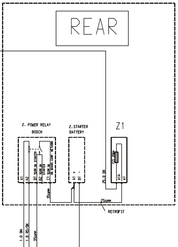

Loren,
you mentioned a second starter relay with the 2 battery cayenne system . Where is that located ?
also is there a way to test the battery discharge relay which is connected to the second battery under the sub?
There are a relay and special circuit (Z1) that determine if the second battery is needed. when it is the power relay switches to the secondary battery.
I believe these are all near the secondary battery at the rear of the car. Please correct me if I am wrong (but I do not have one to look at right now).
Thanks loren.
my issue is 2004 cayenne s 8  cylinder wont start . Tried starting last week in the artic cold we were having in pennsylvania ( 5 degrees ) ran for 15 second then died , tried staring a few more times and engine would slowly crank but would not start . Tried starting a few more times and now cranking at all and not even a noise from starter . Did notice a burning electric smell but couldnt tell if from cab or engine area.
changed battery under seat , no change .  Replaced starter relay in E box , no change
checked second battery and have 13.4 volts , but when i try to start i get a loud click from the battery discharge  relay next to second battery .
i get full power to lights, cab, radio, fan, etc..,
how can i test starter without pulling off intake ? Could i jumper at the relay ?
could engine have seized ?
never had starting issues until this artic cold snap .

Rising resistance inside the primary cables.  While this is a very common problem on 996 Porsches, and PCNA released a TSB and redesigned cables as the result, any primary cable can develop internal resistance which causes both a voltage and amperage drop, which can place a strain on electrical components like the starter.
Testing for it is quite simple:  You measure the voltage at the battery end, and then at the starter end; if the voltage drop is more than 0.5 Volt, the cable is toast and needs to be replaced.
