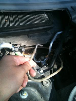

Hi all,
I found this little hose unattached from the other end in the gasket near battery, on the passenger's side. What is it and where should it be connected?
Car is 1997 986, US-model.
Thanks!

That is the vent line for the battery - it should be connected to the battery vent.
Ifg your battery does not have a vent then I highly suggest you get one that does. Acid fumes and vapors will do damage when left unvented inside your front trunk.
