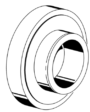

Do you think it is item 11 or item 12?
To get the correct part number I will need you to PM me your VIN.
999.113.347.40 Axle shaft sealing ring 48 x 68 x 10 -- US MSRP $26.4
Removing sealing ring for halfshaft flange
Note: Protect drive shafts from damage. (Use 30 mm piece of hose)
