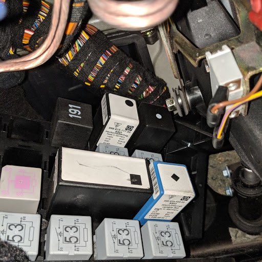

Look here: http://www.renntech.org/forums/index.php?showtopic=2470&hl= Just cut the diode in the "abgassklappen relays". This will prevent the speedo signal reaching the electronics of the PSE only. All other circuits needing the speedo signal ( including PCM ) remain intact, no side effects.

Yes it can, the diode is the speedo signal only. So, after cutting this diode, you can switch the dashboard switch, on off . ( In fact, i switch my PSE OFF most of the times ... ) PSE is default ON , so switch off whenever you want.
Yes, the relay is inside the car. just have a look under the dashboard, you see a little "box" abgassklappen " Pull it out, en open it, you will see the little orange colored diode, going to a pin market " 1 "

You will not have the cut out at approx. 45 kmh / 28 mph to approx. 68 kmh / 42 mph. if the electronics and vacuum controls were not installed. In a factory option install the electronics and vacuum stuff is always installed. If a dealer (or owner) installed then it is optional. Without the electronics and vacuum stuff the exhaust is always open.
As a part of the aftermarket PSE installation, there is a single grey/pink wire that plugs into jumper position 23. At jumper position 23, there exists a number of grey/pink wires that are installed at the factory ... along with empty slots where one can plug-in the added aftermarket PSE wire. The aftermarket wire terminates with a spade lug that plugs directly into the back of the jumper.
You can avoid the 30 - 45 mph cutout by simply not connecting the aftermarket grey/pink PSE wire to jumper 23. Everything else works as expected, including the dash mounted on/off switch.
There is no need to do the "hack" on an aftermarket PSE installation. Simply unplug the new grey/pink wire from jumper 23. It should be obvious which grey/pink wire is the aftermarket wire, as it is not a part of the large factory bundled wire loom.
