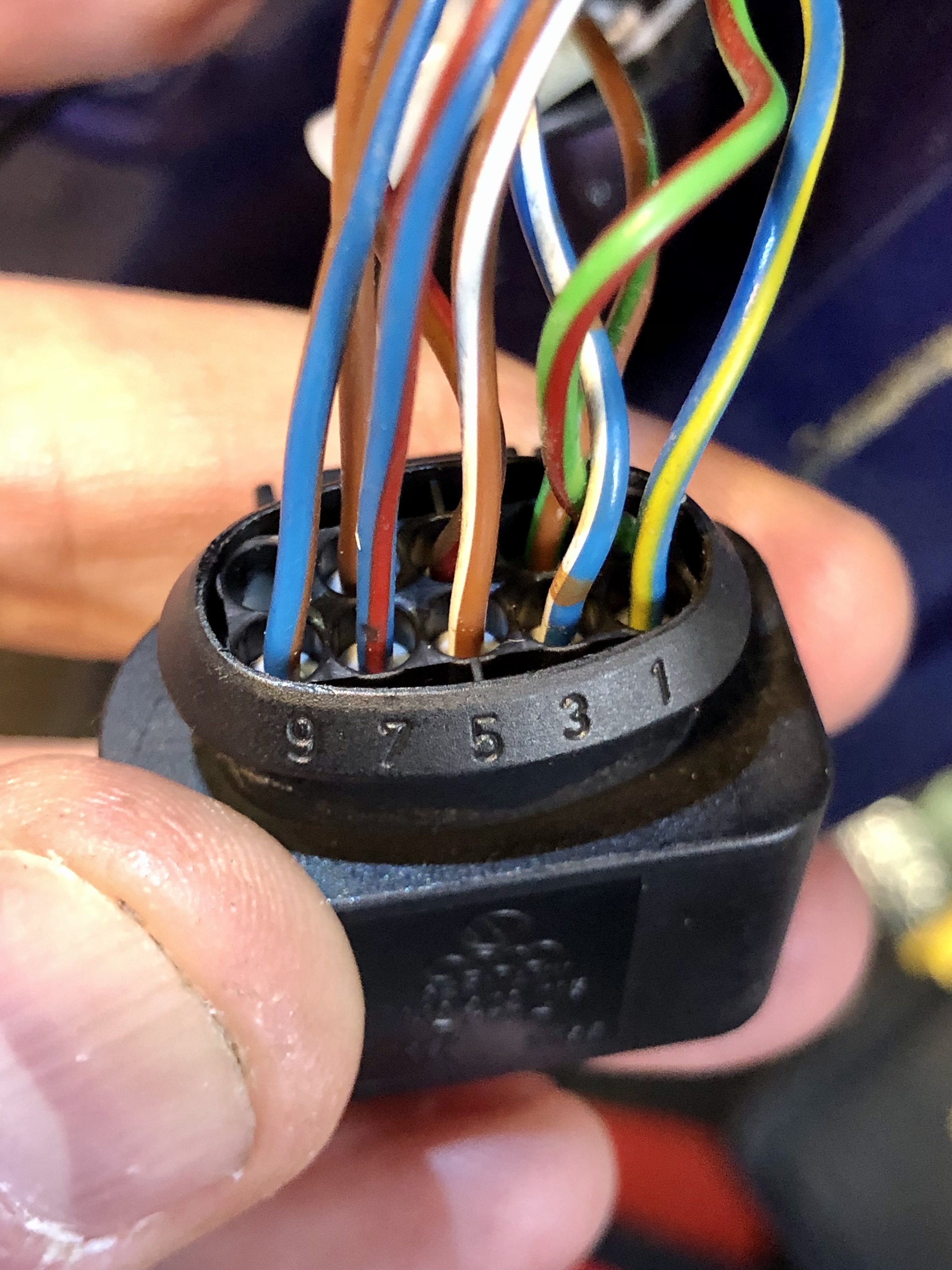

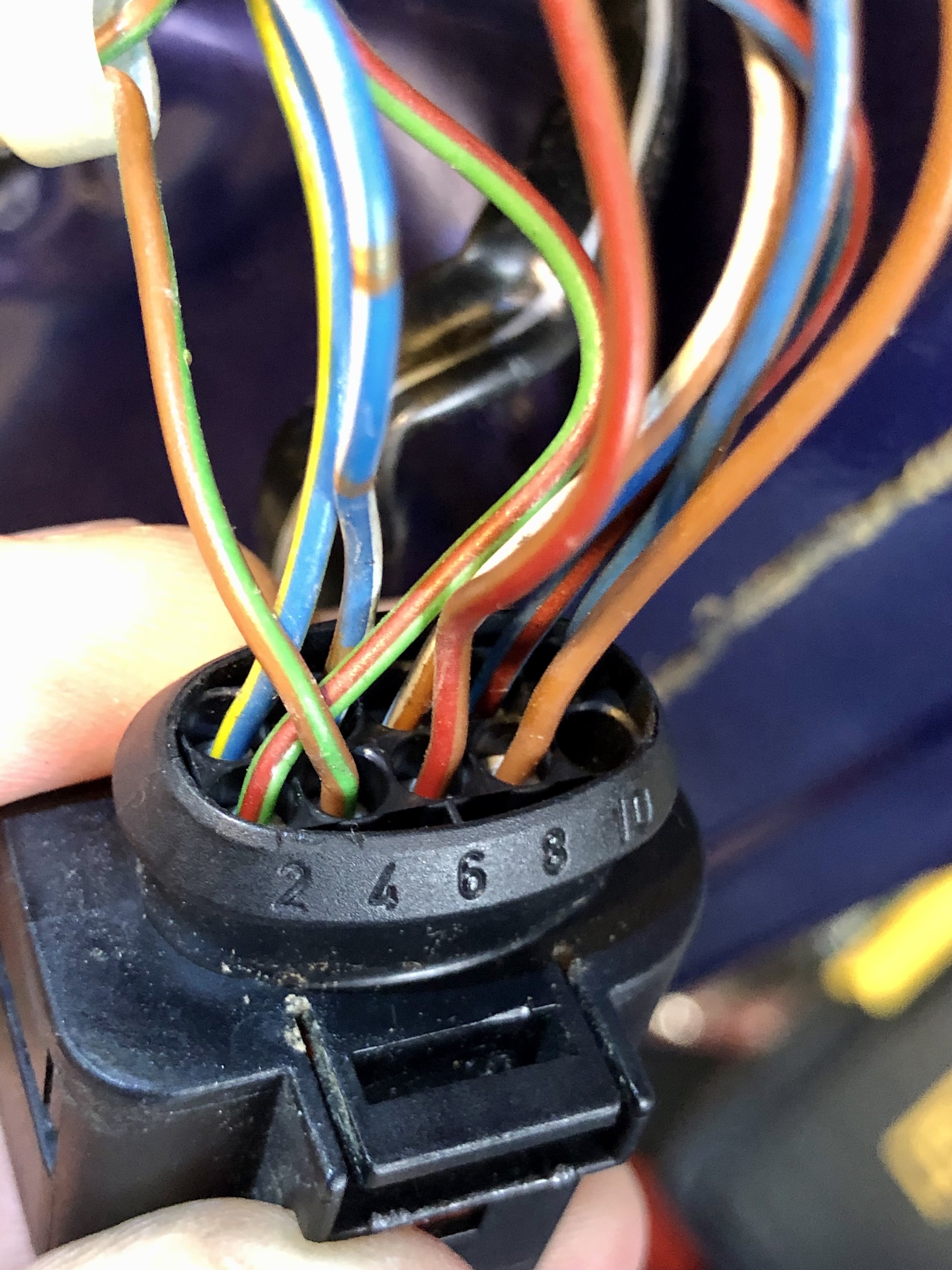

TROUBLESHOOTING ELECTRICAL
  • As I'm not an electrician (accustomed to reading diagrams), I mapped out my own diagram in the form of the 9-pin connector so I could see what was happening with each wire to make sure something there wasn't a troubling contact or shorted wire to eliminate those before assuming it was the locking mechanism.
387992320_Lock9-PinConnector.thumb.jpg.7ea97bf73532c899fbfecdec846f15c2.jpg1678073097_Lock-9PinConnectorWires1.thumb.jpg.7c73e9f2b9fa7fe155b1f6f1bf2501ea.jpg2035930498_Lock-9PinConnectorWires2.thumb.jpg.9a2f62401b885d92f4ff693729513346.jpg
  • Since this was my first project (of several to come) I researched and purchased an automotive circuit tester to test for ground (earth) and to check each of the connections on the connector. With car off, no key ignition and car door open: Connections #1,2,8,9 showed ground connection; and #4 had 12.8 v, while all others no signal. When triggering key fob, #5 and #7 would momentarily show voltage. I didn't go through the various permutations of door locked and ignition key, etc. to fully validate; with power and ground and no response from locking unit I felt that I had enough to point to the unit being the issue.
  • I am sure there's probably a better / more methodical way to do this, but I primarily wanted to build some basic troubleshooting skills and have a better understanding of how the electronics work. There are scenarios that could involve circuit breaker and other trouble sources, but there were no indicators for me to research further.
