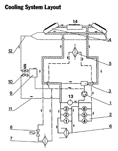

No luck on finding the part in the thermostat. Does anybody have a diagram of the coolant system, so I can determine the next place to look?
Follow the direction arrows to see the next downstream locations.
1- Water pump
2 - Crankcase
3 - Thermostat
4 - Radiator
5 - Heat exchanger, heating
6 - Oil-to-water heat exchanger
7 - ATF heat exchanger (Tiptronic only)
8 - Electric shut-off valve (Tiptronic only)
9 - Expansion tank
10 - Shut-off valve
11 - Venting line (engine)
12 - Venting line (radiator)
13 - Oil separator
14 - Radiator (Tiptronic only)
