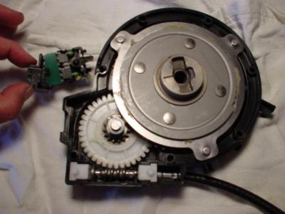

The double relay itself or the little switch points inside the "Stehle" brand transmission on the driver's side (even though the workshop manual says the passenger side).
Here is a photo of the little switch points inside the driver's side transmission:
post-6627-0-73612000-1306549680_thumb.jp
Before taking apart the driver's side transmission, it would be easier and more cost effective to try another double relay, either a new one or borrowed from someone else's Boxster which is known to be good.
