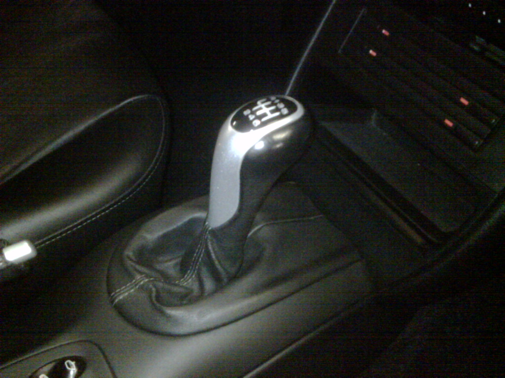

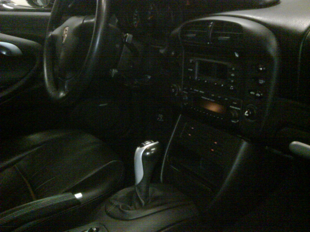

Here is an easy one. One thing I did not like on my 996 was how long the shifter was. My prior car had a shorter shifter and the travel required to change gears on the 996 was bugging me. I did some reading and found many short throw shifter packages out there for $200+. I came up with a $0 solution. I pulled off my shifter knob and leather boot assembly, cut the metal rod down by about 1-1.5" and put the shifter assembly back on. See the attached for basic instructions on how to get the shifter off. Once you unclip the leather boot simply pull off the press fit knob (mine was a little different than the pics in the attached). I pressed a large garbage bag over the rod so that no metal chips would end up in the car. With a hack saw I cut the rod back 1-1.5". Clean up. Put a little lock-tite on the tip of the rod and press the Knob back in place. Then clip the boot in place and your done. $0 and 1 hour max. Let me know what you think.

Any pics?
