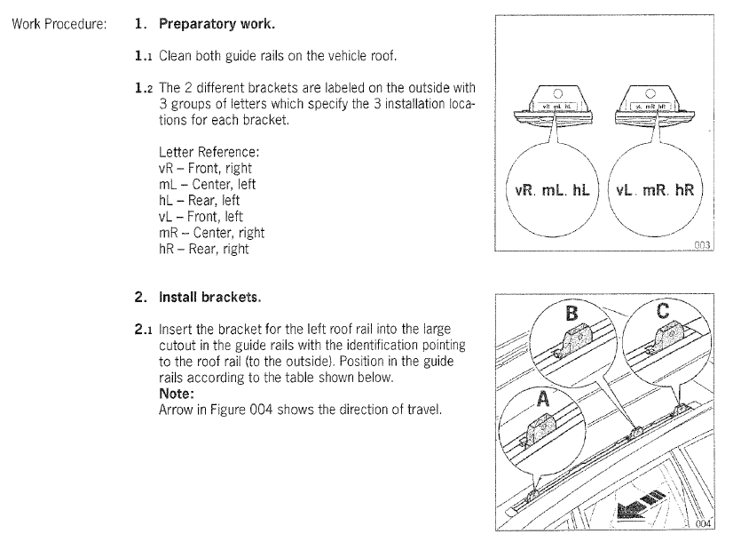

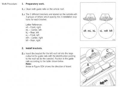

Do you have the 6 page installation TSB?
The bracket are very specific to locations as I recall.

Loren,
Thank you for responding to my request for information. I do not have the 6 page installation TSB, and I am not sure how to locate the TSB. What did you mean by bracket and location, I am not sure what your reference is. The locations that I was using were the notches in the base rails, allowing for even alignment on both sides for uniform locking. Please reply.

BTW: my rails do not have the vR, mL, hL on them, only a picture of the vehicle side view which leads me to believe the front of the image of the vehicle should go toward the front of the actual vehicle.

Some confusion here may be what we are all discussing: 1. the rails that run along the sides of the vehicle roof (part of the TSB Loren sent above) or, 2. cross bars which run side-to-side across the vehicle roof?
I installed the rails (thanks to Loren and the TSB -- be sure to join Rentech.org) and they're excellent. The cross-bars I have seen and they look like a basic installation.
