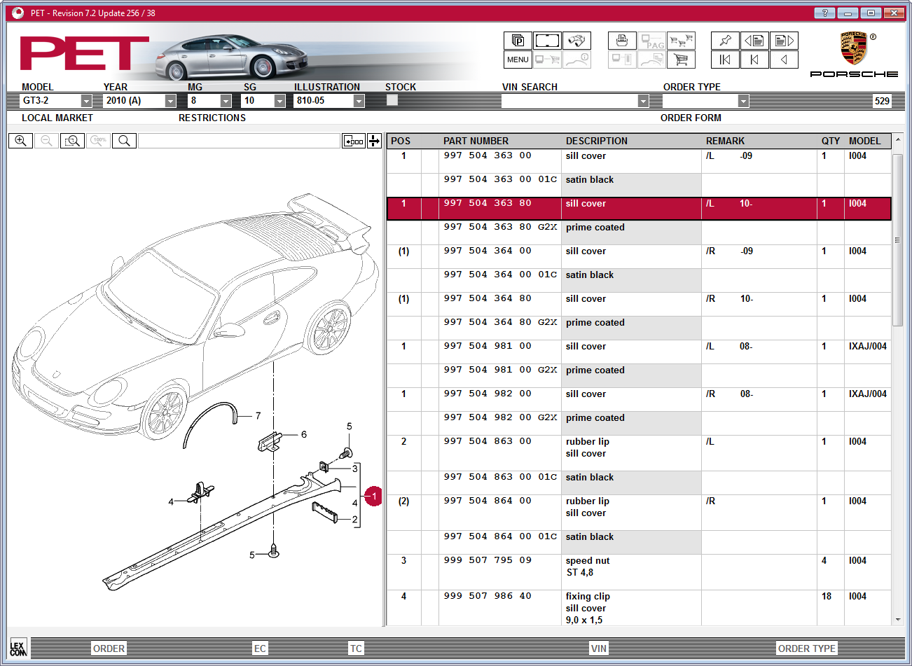

There is a slight flare on the 2010 GT3RS side skirts. I've looked at Porsche PET for the GT3/RS and found these part numbers: 997.504.981.00.G2X (left) and 997.504.982.00.G2X (right). These are listed as prime coated however, I'm looking for the Satin Black version. Thanks in advance.
Darren
:welcome:
What car are you trying to fit them on - because the part number changed in MY10.
MY07 to 09 is one part number and MY10 is a different number - so the MY10 part may not fit older cars.
When you buy a bumper, you need to then paint it. I bet
the side skirts are the same way.
Paul
Paul,
There is a rubber/plastic portion that is mounted at the bottom edge of these side skirts and that is what I think the original poster is after.
Thank you for the responses.
I've purchased an aftermarket 2010 GT3RS Look front bumper cover and also the OEM Front Fender Extension (997.505.365.A1 and 997.505.366.A1) for the front wheel wells. My ultimate goal is to facelift my 2008 Carrera 4S into a 2010 GT3RS. I want to make sure I order correct part number of the side skirt of the 2010 GT3RS. Hopefully, it will fit.
Darren
Loren,
Thanks for the clarification and the screen shot of the PET. The side skirts I would need to order are 997.504.363.80.G2X and 997.504.364.80.G2X. They both would need to be painted.
Darren
