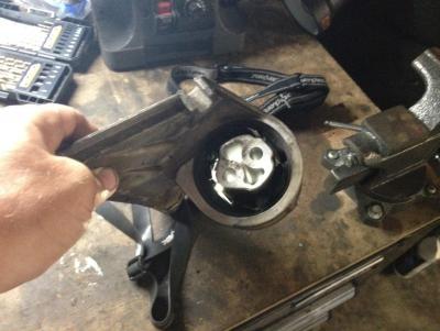

Had a clunking noise coming from what seemed to be the right rear of the car. Initially thought it was the trailing arms. Switched them out (left to right and vice versa), but no relief.
On to motor mount and tranny mounts. Tranny mounts were in exceptional state, considering they must have had 135k on them.
This is what the motor mount looks like.
post-16716-0-55979600-1328107639_thumb.j
Glad it fixed the clunking problem.
