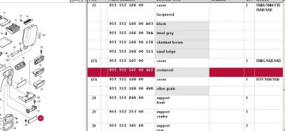

Yes, it can be ordered.
Sorry, what is the wood type?
Rootwood, high gloss olive ash burl, or super matte olive ash burl?

give vin to a dealer he should be look up precise part and print the above picture to tell it could be ordered separately

The section of the console that the lower piece clips into is separate from the entire console. What happens a lot when that piece is missing is the tabs the piece clips into break off. When this happens there is nothing to clip the piece into. The tabs are on either side, check to see if they are still there but I would guess they're not. If they are there then you can definitely order the trim piece separately and clip it in.
