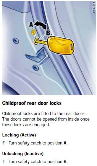

Are you sure the Child Safety Locks are not set?
(from the Cayenne Owners manual)
Share this post
The front and rear doors act in the same way, the childproof rear door locks are mechanical and are independent from Kessy system.
