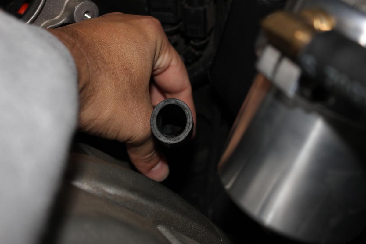

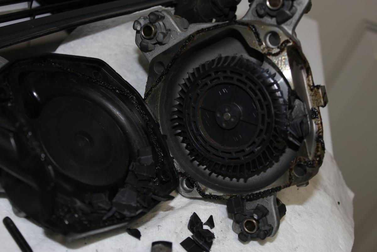

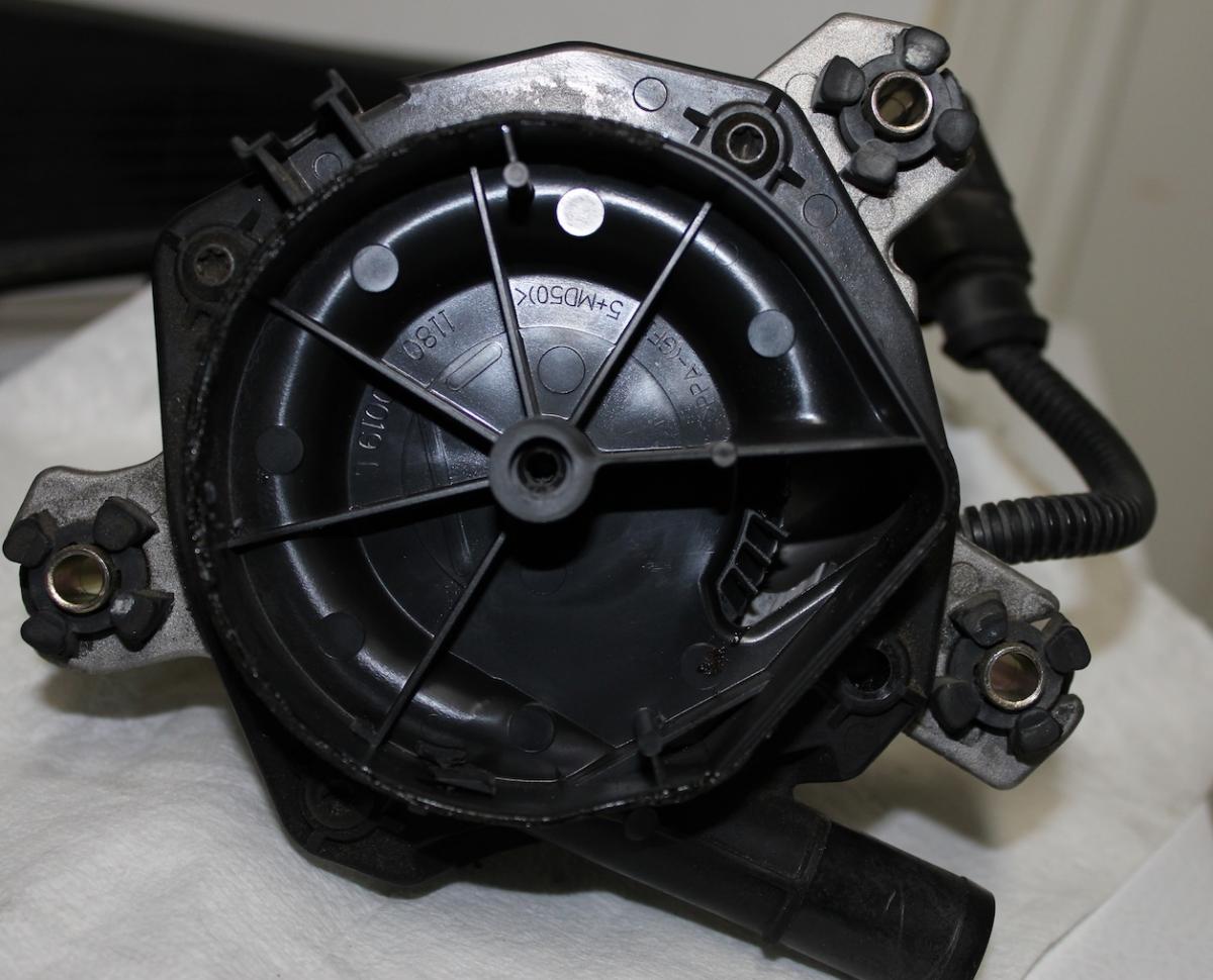

Since there is a thread already I'll add to it. Same P0492 code. Did the troubeshooting and found the bad fuse and while I was at it decided to check the relay and then the pump itself since there is another thread describing the impeller failure in the unit itself. Lo and behold that's my issue. I took some pics of the carnage, but also one of the good blower with the cover off to you can see what it's supposed to look like. I also had to pick pieces out of the hose itself leading to the valve behind the engine block. The cover is held on by the single screw so it's easy to inspect while still fully installed. So if anyone runs into this in the future, you can check the pump and the fuse quickly before moving through the rest of the procedure.
post-35813-0-77300400-1357269945_thumb.j
post-35813-0-56269800-1357269963_thumb.j
post-35813-0-11849700-1357269976_thumb.j
post-35813-0-99519100-1357269989_thumb.j

Nice work, i fixed mine as well. The plug came right out of the socket and was just hanging lose. I plugged it in and i have not had the error since.
I did open my pumps just to double check and they looked fine.
Now if only i could fixed my heated seat issue.
Wanted to post a follow-up. I had a piece of impeller blade make it to the one-way valve and lodge it open. This valve is at the end of the rubber hose the pump pushes the air through. It bolts to the back of the block and I can say with certainty that you need to come in from under the car to get to those two bolts with a long extension (forget what size e-torx it was). There is a gasket, but it didn't tear luckily. So make sure you check the hose otherwise you'll get exhaust backflowing up into a plastic pump...

Can you describe what the open valve sounded like? My 04 turbo with 100K started making a "thumping" noise; not really like a rod beginning to knock, but similar. No check engine light so no code to report, just a noticeable low pitched thumping only at idle speed. It seemed to come and go for a few weeks, then became a constant nuisance. I took it to the dealer for my 100Kcheckup, they said it sounded like an open SIA valve on the drivers side. They quoted $700 to replace it, and I am considering just doing it myself. Were you able to remove the broken plastic pieces and free up the valve, or did you just replace it? If replaced, how much? The cheapest I could find was $125. From your post above, it sounds like it may be a quick fix? BTW, the dealer said they have never done one, this would be their first one.
Great photos of the air pumps!! Were you able to snap any of the valve or its location? Thanks for anything additional you can add!!
No noise that I recall so there was no warning. I replaced it since the vanes that serve to move the air were all broken off. That price sounds good, I paid about $160 You can check the valve pretty easily - just disconnect the driver's side air hose from the pump there in the engine compartment. If it blows exhaust then it's bad. It's just a simple one-way valve so there is no power or vacuum required to actuate it. The air pump just overcomes the flapper and pushes air into the cat. I recall it took a universal joint and a lot of extensions to reach it and even then I had to get the socket into place by feel with my hand -it took some patience.
