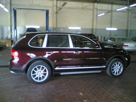

I will put the picture of my car, sorry I have one picture, I took it in the dealer when they were adding a roof trail to it.
