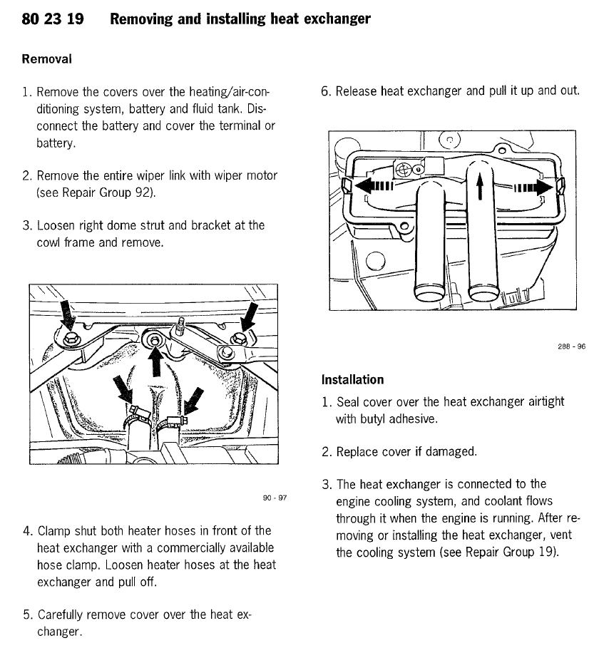

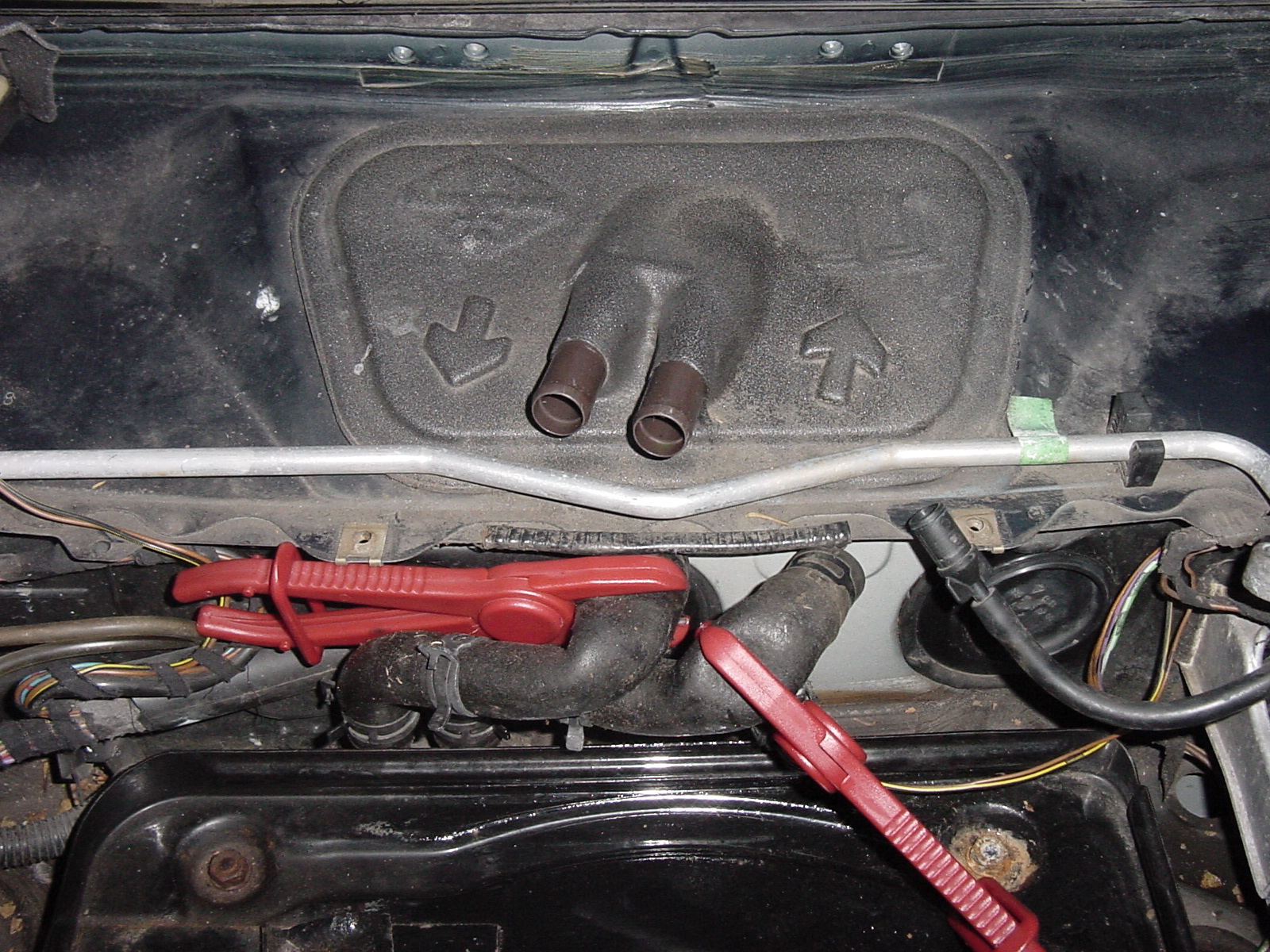

Jose:
For step #4, here is what two of those hose shut-off clamps look like. They are available from PepBoys:
post-6627-0-77196400-1288663579_thumb.jp
Also, pay attention to bleeding air out of the system once you are done or your coolant tank will overflow. If you have a Uview vacuum tool, it will make it that much easier.
Take heed to carefully seal the foam cover or you may end up with leaks of outside water on your feet!
Regards, Maurice.

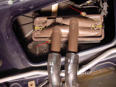

Jose:
Definitely do not have to remove the whole dash or any part of the dash.
Removing the heater core can be done completely from outside the car.
After you carefully unseal and remove the foam cover, you will see the top cap of the heater core.
First disconnect the two heater core hoses. Then unscrew the two bolts that are indicated by the red arrows, then pull the two black plastic tabs (each in the outboard direction) indicated by the yellow arrows, while you pull the radiator core up and out. (Click on the photo to enlarge):
post-6627-0-87312800-1289188221_thumb.jp
If you find a little puddle of coolant at the bottom, as in the following photo, that will confirm that your radiator core was leaking:
post-6627-0-90389300-1289188672_thumb.jp
Regards, Maurice.

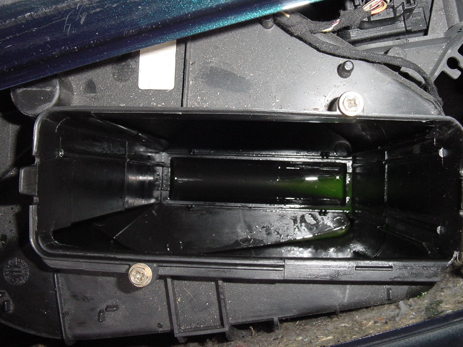

As I promise my Porsche already hybernate, the winter is gone here in Michigan. I just want to follow up my thought about the coolant smell thru air conditioner and in fact was true. My heater exchanger was leaky as I check thru the proper steps. Here I include few pictures. I will order the Heater core today as I don't think Porsche have in stock, I'll try pelican parts first. As you can see in the pictures there is evidence of deposit residue and the bottom of the heater exchanger.
Well, that's all.
:thankyou: B)

Jose:
Looks like you definitely found the problem.
You might want to consider taking your heater core to a radiator shop and to have them evaluate whether it's possible to seal it. They can usually turn that around in a few hours and it's going to cost a lot less than a replacement from Porsche.
Thanks for posting your progress and the photos.
Regards, Maurice.

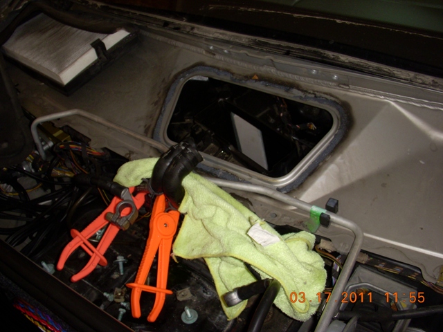

Hi, today I removed the heater core to repair the heater flap. It was pretty straight-forward to remove it, but I got somewhat of a surprise; even though I just have replaced all the coolant with new red-ish one, the coolant in the heater core was the old green!
To me that points towards no circulation, meaning air pocket in heater core. Is there an other reason for it, that I need to adress?
Thanks,
Johan

Best do a full system flush, vacuum refill and then test the heater core to see if it gets warm.
