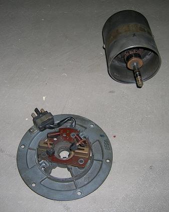

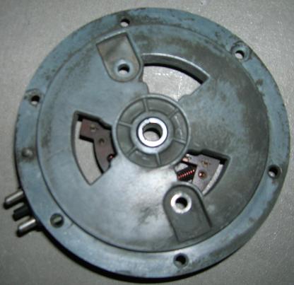

I just pulled the engine blower motor out as it was making significant noise when I engaged the automatic heater. I removed the fan blade assembly and removed the rear cover screws. Seems like the bearings are shot where the motor passes through the upper round plate beside fan assembly. I noted that replacing the motor assembly is in the $550 range, which seems somewhat excessive for simple bearings. The motor works well, so am just wondering if anyone has changed the bearings on the motor before and whether it is in fact possible. We have a local bearing place that I was planning on going to when it opens on Monday. Any thoughts?

Well after a fair bit of running around, I managed to find an Aurora Rod End / Hime Joint? which I was able to cut apart and separate the hardened steel bushing (got that from General Bearing Service Inc in Ottawa, Ontario). I wasn't able to expand the 5/16 inch shaft diameter as no drill bit I could find, would hone the bushing (just chewed them apart). I found a local machine shop that was able to hone the inner diameter to 8mm (as per the main shaft) in less than an hour for $90 CAD. They also repressed the bushing into the plate so I simply had to reverse my disassembly to put it back together. Only challenge was not losing the small pressure 'c' clamps in the basement. The heater seems to work again, with no noise eminating from the motor. Have attached a couple of pictures for general situational awareness. I may make a recommendation to Pelican to perhaps see if they could stock such an item. Thanks again.
