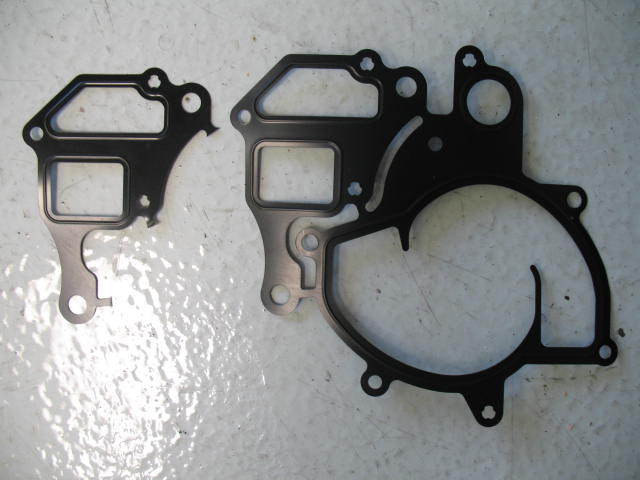

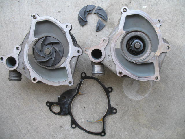

Only use the OEM type metal gasket, no sealant is needed, do not reuse the old metal gasket...................
