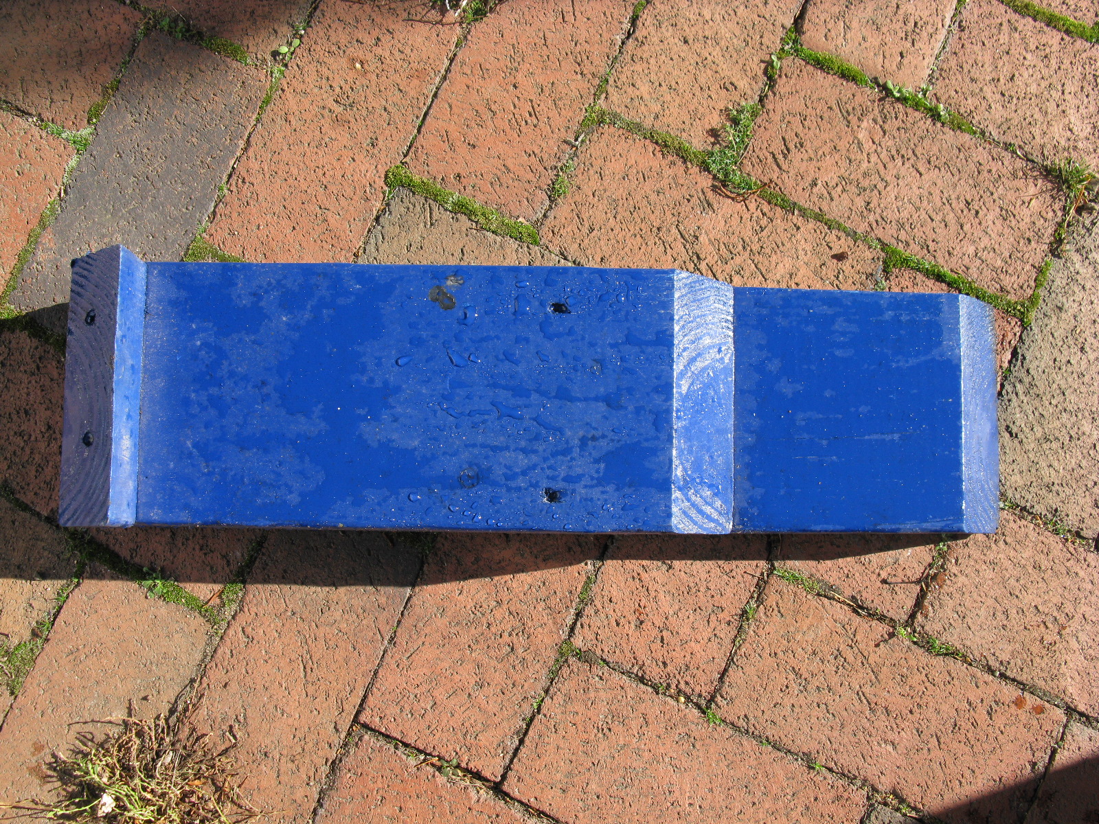

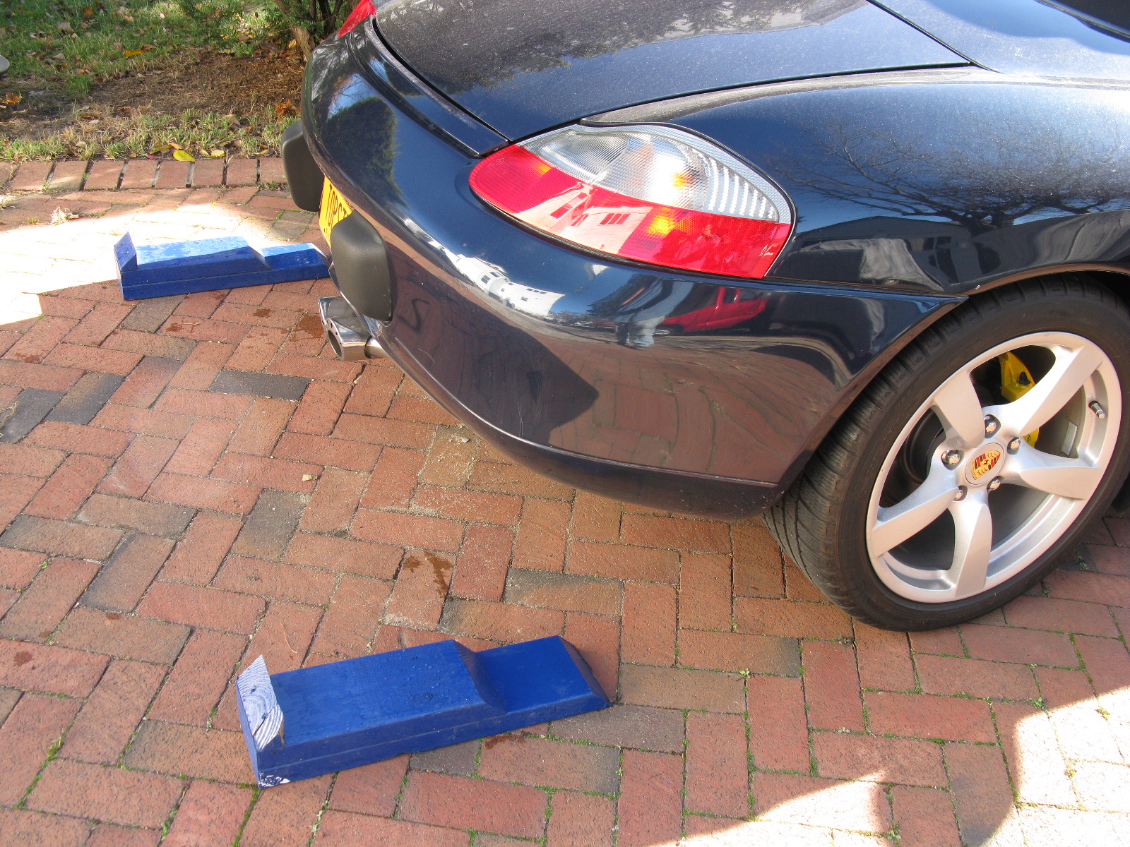

For extra comfort under the car, you can screw together two 2X10's, with the lower one being about 2 1/2 feet long and the upper one being about 1 1/2 feet long, and both of them being cut on a 45 degree angle at the front and a small block of wood screwed in at the back for a stop. If you are not claustrophobic, you can manage it with just one thickness of 2X10. You can then just back up the left rear wheel onto the small ramp you have created and access the drain plug (8mm Allen key, IIRC) and oil fliter housing. If you want to go further, you can make two sets of ramps.
I'll post a pic of some extra short ones that I have made and they work fine, but you can make them longer and with a bigger "stop" at the end.

you can get the filters at good price at sunset porsche in oregon for most all gen porsche parts. Can get OEM type at pelican for cheaper- buy a few and keep a few xtras on hand- you may also want to get a LNE drain plug from pelican parts or from LN Engr directly-it doesn't strip like the stock one's do. Rhino ramps are only $20-25 at checker or others big box auto stores & easy to use. be sure your oil drain pan is big and holds a min of 3 gallons- bigger is better- i found the cheap plastic
