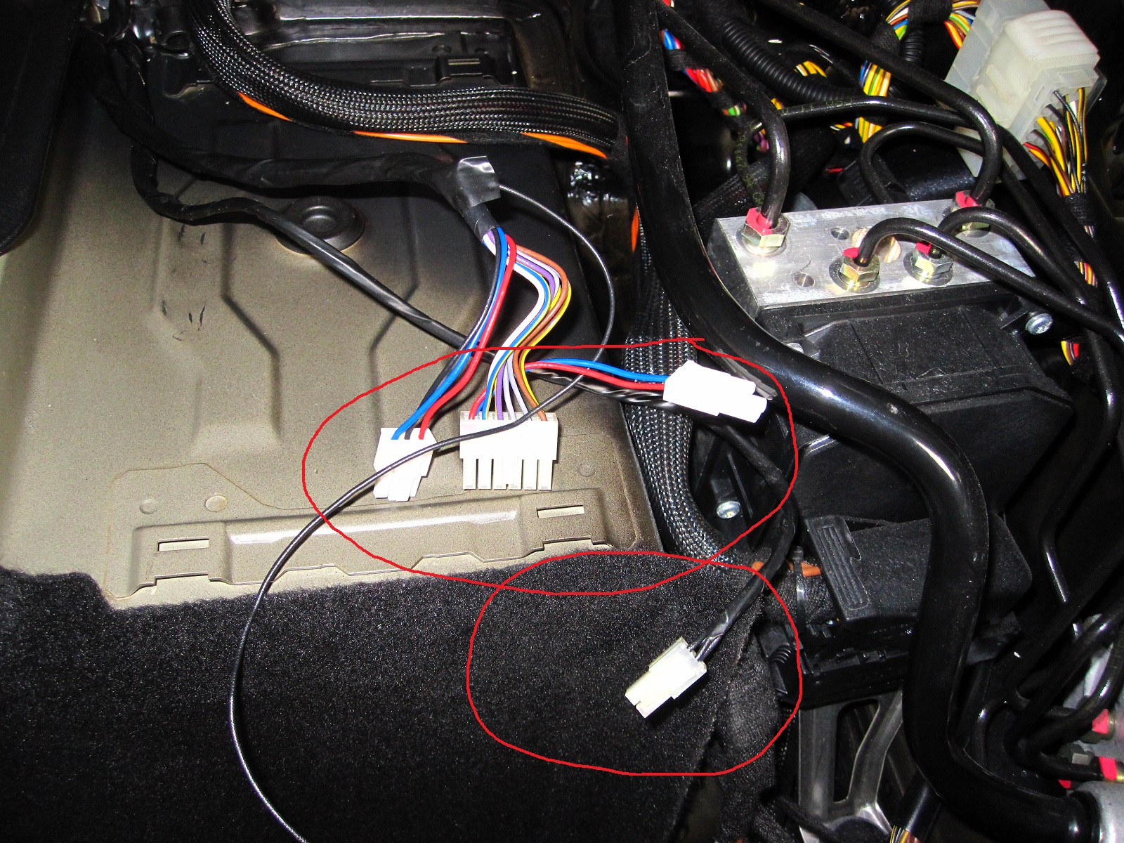

So I was dismantling the plastic bits and pieces of the trunk tonight, and I came across 2-3 bundles of cables that have nothing attached to them.
I thought I'll post the pictures here, and see whether the experts here can tell me what they're for.
Hopefully something cool like iPod connectivity etc..
The car is a 2003 996 C4 Cab, RHD, UK spec.
post-61448-0-45290500-1291014261_thumb.j
cables look like they work with the seat motors to control auto seat adjustment, and possibly headed seat connectors. the computer is under the drivers seat, and if any crucial cables were not properly attached I would think the car would neither start nor run. You'll to check carefully with a wiring guide diagram I think. good luck
I don't have electric seats (apart from the seat back), and my heated seats are working.
The car is working fine.
Share this post
It would be helpful if you could list the factory electronic options. Does your car have NAV and phone? As your car is an 03 MOST-based system, the wiring is very different from the earlier vehicles. It is hard to tell from the photos, but as Loren suggested, the amp may have been removed. On my 2000 C4 cab, the amp is mounted vertically on the tub adjacent to the strut mount. The two clips in your photos are the same as my car and hold the CD changer.

They somehow don't look like Porsche connectors to me. Porsche loom tape is fabric, and that looks like plastic. The connectors in picture 2 look like they might be GPS connectors, but I don't know what they all are. I think Loren might be right about the amp being removed though.
Where do those two orange fibre optic cables go?

These cables are not OEM cables. They are probably either an aftermarket audio setup or a anti-theft tracking system that was removed. See if you can find out where they go in the cabin. I would suspect that the other end is in the center upper console. Since your car uses the MOST Bus for the stereo, the 2 small cables are probably fiber optic cables used for the CD changer or other audio device.

Thanks all for chipping in.
I thought the same too about some audio equipment that been removed. The stereo in the car sounds wonderful though while it's not Bose, it's sounds really good.
I haven't tried to trace the cables specifically, obviously they disappear into the next section through a rubber grommet next to the power steering unit.

You have/had the Harman sound package, which has similar connections to Bose. I expect the two cables I asked about go to the CD changer.
Cheers for the clarification. I can't tell which audio system I have. Pulled out the right-rear speaker, and there is no audio manufacturer name at the back of the speaker. It only says Made In Germany.
My CD changer looks like the bog standard Alpine setup, with Porsche stamped on its door. And it still works.

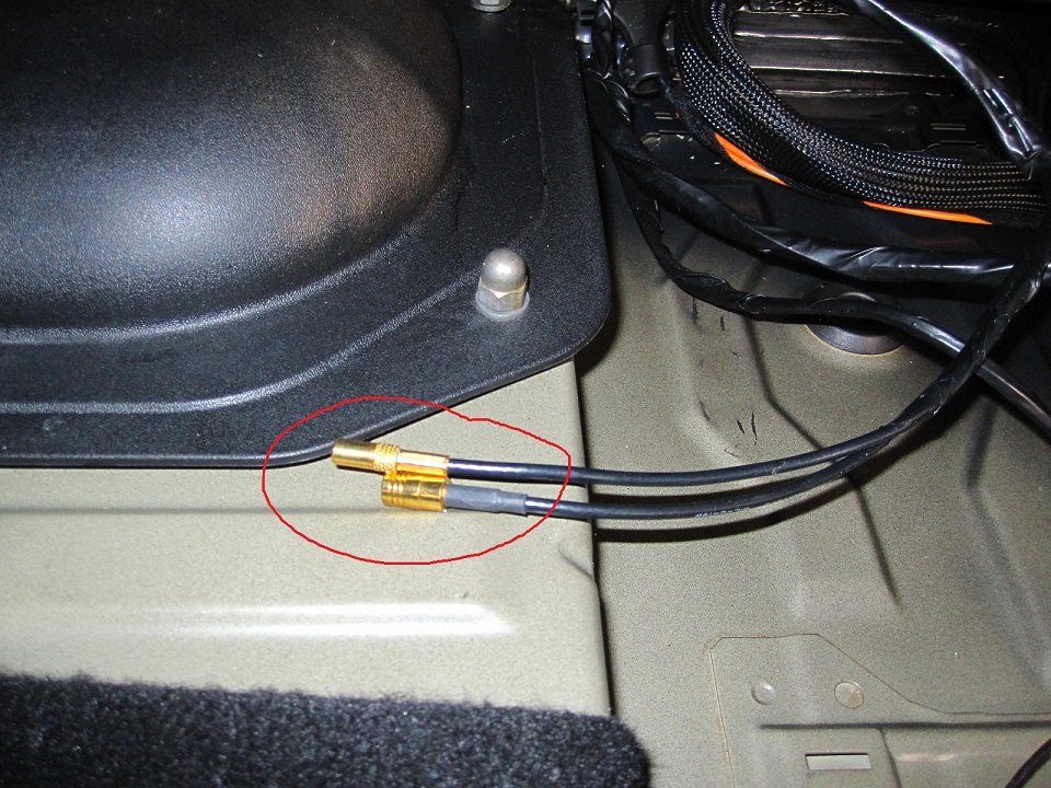

Second picture
post-61448-0-33098800-1291014692_thumb.j
sorry, when I first looked at this I thought the picture was under the seat. I can see now its in the front. I agree, aftermarket audio stuff.... cheers,
