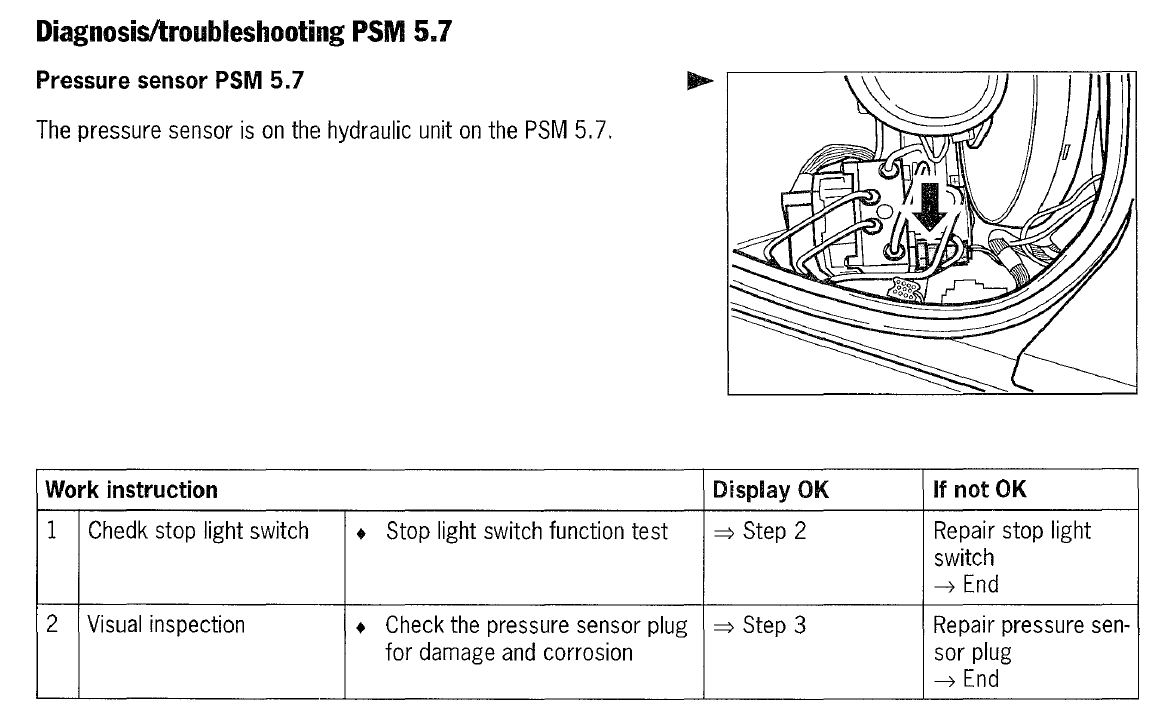

Fault code 4460 -- Pressure sensor
Possible cause of fault
- Short circuit to ground/voltage or open circuit in circuit to control module terminals 25, 26 and 42
- Plug connection on stop light switch faulty
- Adjustment of the stop light switch not OK
- Wiring/ plug connection faulty
- Pressure sensor faulty (replace hydraulic unit)
