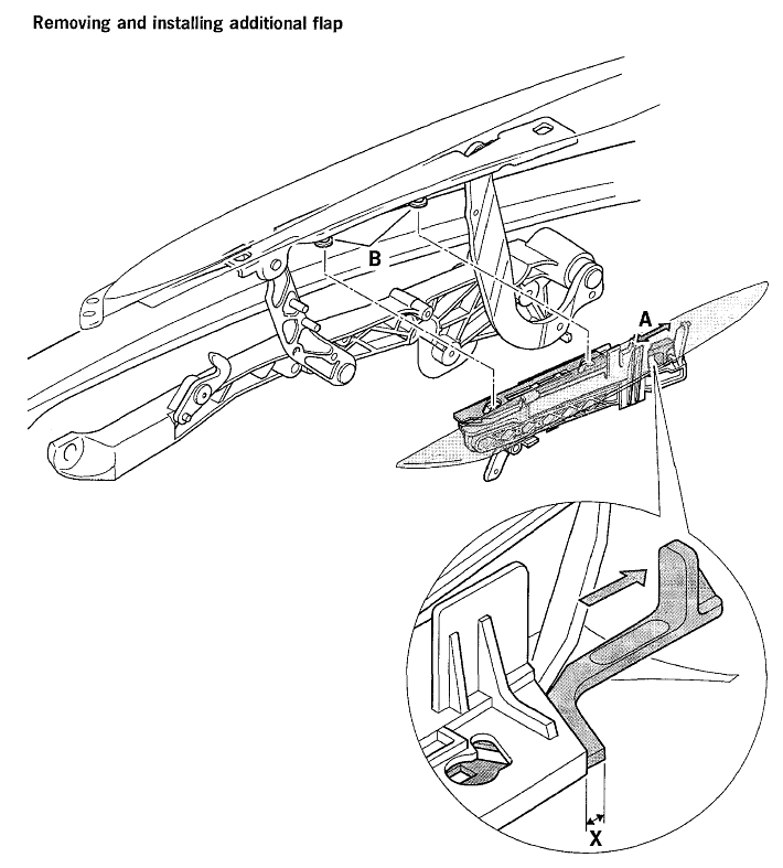

The parts go inside the bay of the soft top as the top is being lowered. There is a left & right side. The previous owner pulled them out as they are broken but never replaced them. I need to know what funtion they perform as they also have a spring. Also, how to install them.
PART# 996.561.061.02
996.561.062.02

I think it protects the top flap mechanism from debris and people sticking their fingers in there.
Installing additional flap
1. Insert additional flap upward onto hinge pins 8 of the CTCL and pull forward.
2. Pull locking lever A backward (against direction of travel) to lock the additional flap. The additional flap is locked if locking lever A projects approx. 5 to 8 mm over the body of the additional flap in the area of dimension X.
