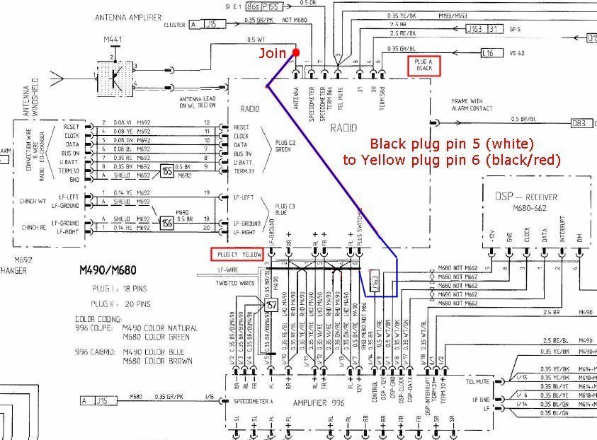

I can't seem to make that link work, but if it is like the Crutchfields one which connects to the M490 amplifier, then you need to add a wire to give a signal 12v to the amplifier. This is usually a blue wire in the adapter cable, and you should connect it to the 12v antenna output from the head unit.
post-4000-0-68693900-1293006984_thumb.jp
post-4000-0-11369200-1292865451_thumb.jp
Edit: Diagram edited for clarity

You need to connect the LINE outputs from your new head unit to the amplifier in the trunk - not the speaker cables, using the adapter cable like the orange one in my picture above.
Pin Number Wire Color Function
5 Blue/White Amplifier Remote
6 Blue Antenna Remote - to "Exhibit A" pin A5
7 Red Accessory 12 Volts - to "Exhibit A" pin A7
8 Black Ground - to "Exhibit A" pin A8
13 Sky Blue Telephone Mute - to "Exhibit A" pin A3
14 Orange/White Illumination ( the wire isnt there ) - to "Exhibit A" pin A6
15 Not Used Not Used
16 Yellow Constant 12 Volts - to "Exhibit A" pin A4
As I said, you will need to connect the blue/white wire on the orange adapter to a switched feed. Most people hook it up to A5 with the antenna switched power, but you may be able to connect it to pin 5 of your new head unit.

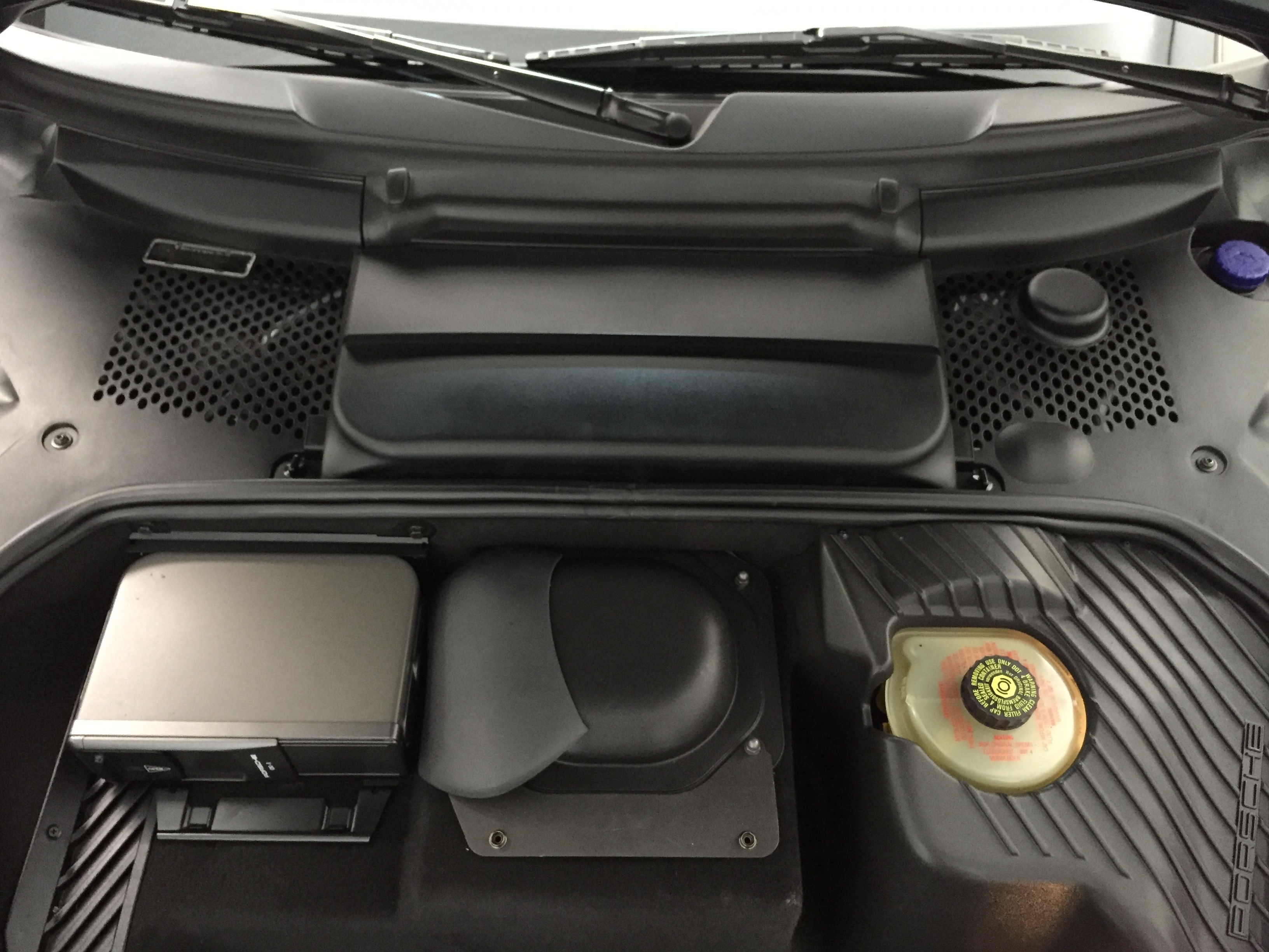

Hello - I am struggling with connecting my replacement stereo for my CDR-220 in my 2001 Porsche 911 Carrera 4.  I have looked at tons of forums and every ones setup seems slightly different.
I don't believe I have an amp, just the CD Changer.  I have included a picture of the trunk below.
