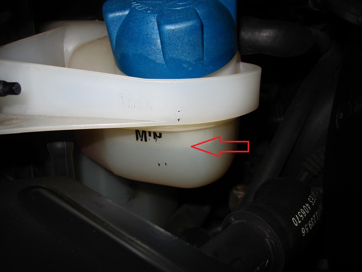

So I've been to the engine bay (again!), poking around, as you do.

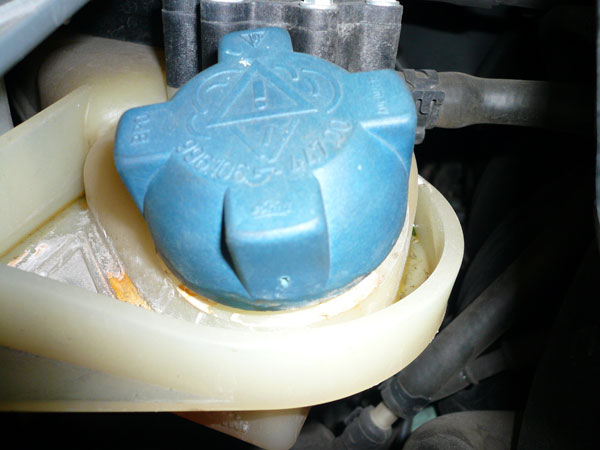

Checking the coolant level, I was somewhat surprised by the dampness around the overflow(?) area under the coolant cap. See picture 1, this is the area I pointed out with the arrow. Is this normal?
I have dried this area to see whether the same will happen again on the next drive. This is a weekend car so doesn't get out that much.
I've heard that the coolant cap might need updating, mine ends with 01.
The reservoir tank doesn;t have the full Max - Min indicators, see picture 2. Based on what's shown in the picture, I'd like to know whether my coolant level is adequate. The current level is indicated by the arrow in the picture.
The car is a UK-spec, 2003 C4.
Thanks for your feedback!

Arrow indicating coolant level seems about right to me. better to be closer to the minimum level, I think, to prevent overflowing. also, I was recently advised to upgrade the coolant cap to the one ending in 04. Cost was about $30 from Sunset Porsche. New cap arrived about 2 days after ordering by phone.

For sure replace the "00" cap. Those are known to leak. Get the latest version your dealer/OPC has.
I would use only Porsche coolant as mixing the wrong kind can have a disastrous effect.

One other issue on the coolant tank cap.
1. make sure that it is not cross threaded on the tank.
2. make sure that it is fully seated. The cruciform top of the cap should be straight and level in relationship to the ground. There is a slight "click" feel to the cap when it is fully seated. Because of the compression of the cap gasket, it is sometimes difficult to get the cap fuly seated.
Here is a cap that is not fully seated:
And here is one correctly seated:
Your picture seems to indicate that your cap is not fully seated.
