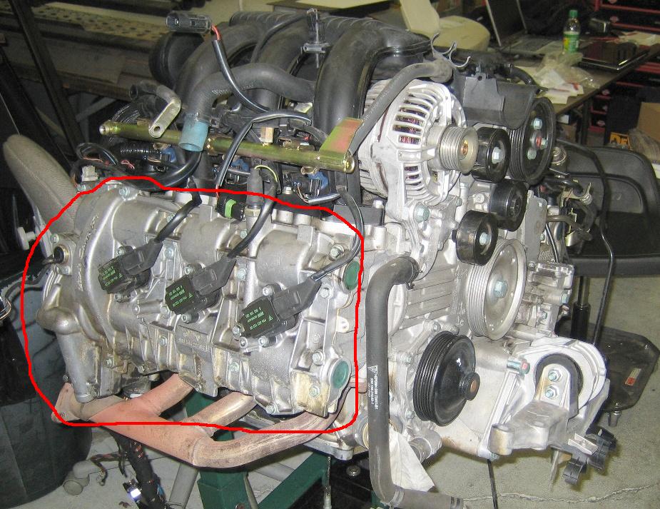

As far as the dealer not being able to tell the difference between a cam cover leak on the one hand and either an RMS or IMS leak on the other hand, if you will just look at the layout of the engine you will see that the cam covers are on the "outer edges" of the engine, while the RMS and IMS seal and encapsulated bolts are at the rear centerline of the engine, one above the other.
I don't know how they can definitively say that it's now the RMS because, short of pulling off the tranny, there is no way to tell whether the leak is coming from the IMS area or from the RMS.
So, it might help if you ask them to put the car up on their lift and ask them to show you where the cam covers are and approximately where the RMS and IMS bearing and flange would be located.
Take a look at the photo and diagrams posted on Mike Focke's website for an idea of what the cam covers look like and where they are located, here: http://sites.google....2/camcoverleaks
Here is that photo:
post-6627-0-79597800-1294376062_thumb.jp

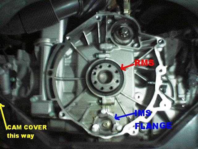

By contrast, here is a photo of the rear of the engine, with the transmission off, for an idea of where the RMS and where the IMS flange is located:
post-6627-0-32870500-1294375890_thumb.jp
Good luck and don't let the dealer snow you. You work too hard for your money to let them take it from you without having earned it!
