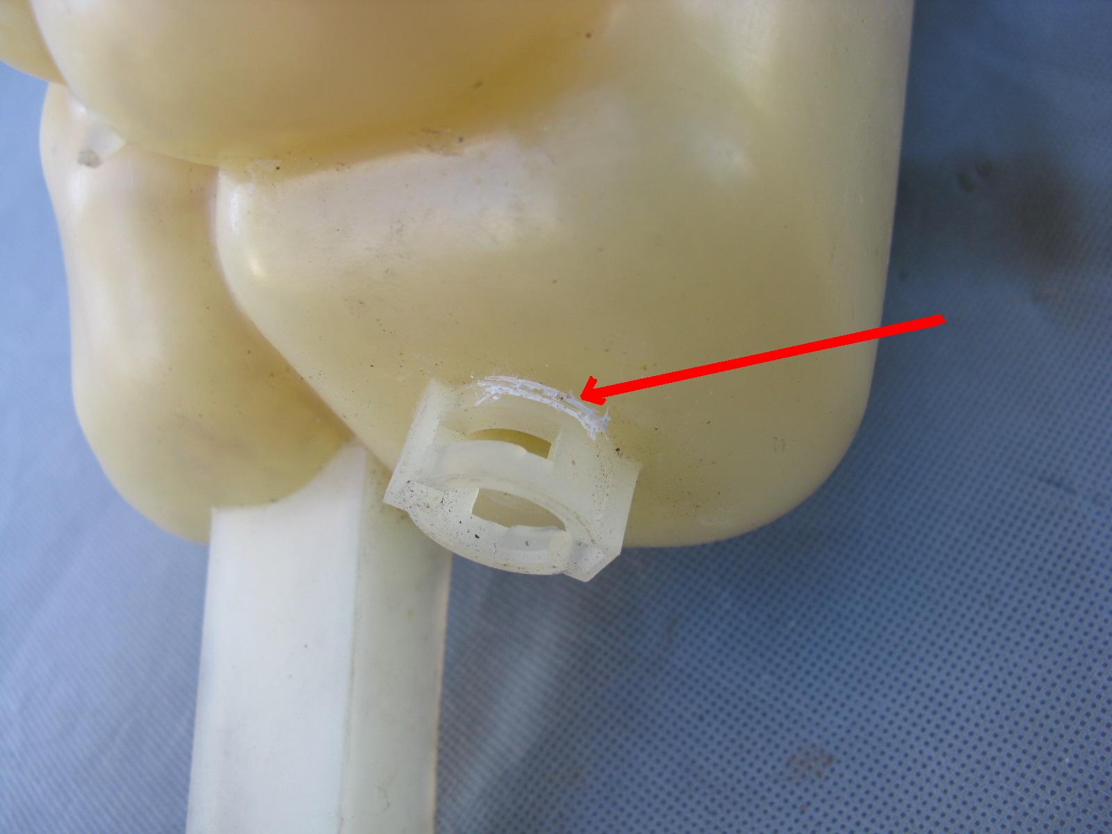

Mine was almost in the center bottom - it will vary. I found a picture online that appeared to have a leak near the same area as mine. I have circled it. I had a hard time finding the leak also and it only did on heavy pressure. If you can feel around, you should eventually find residue solidified around the area. I never pinpointed it until it was removed.
PITA to replace, but in my opinion, worth a DIY :-\

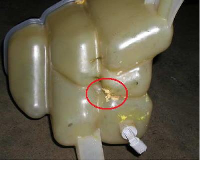

Here's another place where one of mine leaked:

Regards, Maurice.

Mine was like the first pic with a crack along the bottom. Have you pulled up your trunck carpet? My leak got quickly worse from the first time or two I topped off the coolant to when I fixed the problem (about a month later).
Not a terrible job if you heed the directions on the various forums. Took me about 4 hours, most of which were spent trying tighten up one of the hoses upon reassembly.

Maurice, I wish my leak was there. It would have been be quite easy to patch that, I would've thought.
dghii and por986, I had a feel underneath my reservoir for the leak, and all those dimples got me confused. But I think mine might be in a very similar location. Strictly aesthetically speaking, that's one dam ugly reservoir Porsche used!
