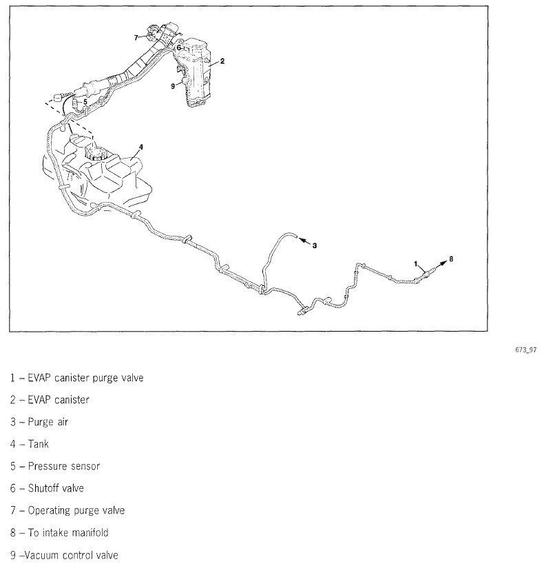

Hi guys,
I got the CEL and my Durametric read out the error code P0442. Since I've been super busy recently, I did a quick test and then I took the car into a local mechanic shop instead of working on it myself.
I understand there are 3 main sections/steps to look deeper into (also check the attached system diagram):
P0442 Repair Outline:
Section 1. Check "tightness" (i.e. ability to hold vacuum) of shut-off value
Section 2. Check ventilation lines for leaks
Section 3. Check tightness of EVAP canister purge valve
(I did a quick test on Section 3 since I can access this valve from the rear. Testing just the valve seemed to indicate it works alright).
The shop seemed to have done only section-1 (from tech's hand notes).
Section 1 is basically:
1-a ) Remove front right-hand wheel housing liner.
1-b ) Test the shut-off value (i.e. apply battery voltage and create vacuum -> see if it holds)
1-c ) Replaced the shut-off value (since it didn't hold pressure)
Just for 1a-1c, they've have charged me ~3.5 hours in labor @ about $110/hour. That's ~$ 385 in just labor for 1a-1c. This is a 3rd party independent mechanic, California.
I have 2 questions
1) I think it should NOT take a professional mechanic, specializing in Porsches, 3.5 hours to do just the section 1 work. That's just my opinion.
So, how long do you guys think it should take for a shop to perform just the section 1 repairs?
2) Next, how long do you think it should take to perform the section 2 repairs i.e. check the ventilation lines for leaks?
I just got the same error code (P0442) back and since they might have done section1 and I did a quick test on section 3, I might need to revisit the shop to get section 2 done. So some knowledge would be helpful.
To those who don't know, section 2 details are at the bottom of this post:
This story is far from over ... sigh!
Thanks!
Sid
Section 2 details:
Use a HC (HydroCarbon) tester and to check the following locations (also check the diagram below)
2-a ) Tank cap
2-b ) Line connections to EVAP canister
2-c ) EVAP canister
2-d ) Line connection to fuel tank sender unit
2-e ) Pressure sensor
2-f ) Opening of fuel filler neck into tank
2-g ) Line connection of EVAP canister purge valve
2-h ) Ventilation lines:
2-h-i ) from EVAP canister to operating purge valve
2-h-ii) from operating purge valve to tank
2-h-iii) from EVAP canister to EVAP canister purge valve
Any reading over 1000ppm is bad and under 50 ppm is good.
post-8807-0-88425400-1296449101_thumb.jp
Edited by siddharth
The labour rate seems excessive. The first thing to inspect is the fuel cap seals and replace the cap if suspect. I never fault trace codes unless they return after being cleared and a smoke tester is the best tool for checking for leaks in the EVAP system. It's best to just clear the code and play a waiting game to see if it returns.
Thanks for the response! Come to think of it, I forgot to mention a few things that you raised:
- I did replace the fuel cap with a newer cap
- this code does keep coming back ... **** P0442! Played this game for several weeks and MANY times :(
+1 on smoke machine since your code is indicating a small leak so it's hard to detect even if they were to vacuum test every single EVAP line. Otherwise, I'm afraid it's a fishing expedition :(
Oh on the bright side, at least it can be reproduced and it's not intermittent so hopefully easier to track down.

I know this thread is quite old but was there a resolution? I too have the same issue and have tried all the vacuum tests, repairs and cap replacements. But still every 100-150 miles the CEL pops up with p0442. Any suggestions appreciated! Thanks!
