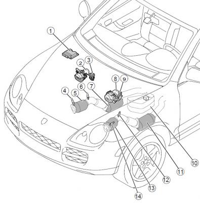

1 - DME control module
2 - Secondary air injection pump, bank 1
3 - Secondary air valve - mechanical, bank 1
4 - Oxygen sensor in front of catalytic converter, bank 1
5 - Pre-catalytic converter, bank 1
6 - Oxygen sensor after catalytic converter, bank 1
7 - Main catalytic converter, bank 1
8 - Secondary air injection pump, bank 2
9 - Secondary air valve - mechanical, bank 2
10 - E-box in radiator tank with fuse and relay carrier
11 - Main catalytic converter, bank 2
12 - Oxygen sensor after catalytic converter, bank 2
13 - Pre-catalytic converter, bank 2
14 - Oxygen sensor ahead of catalytic converter, bank 2

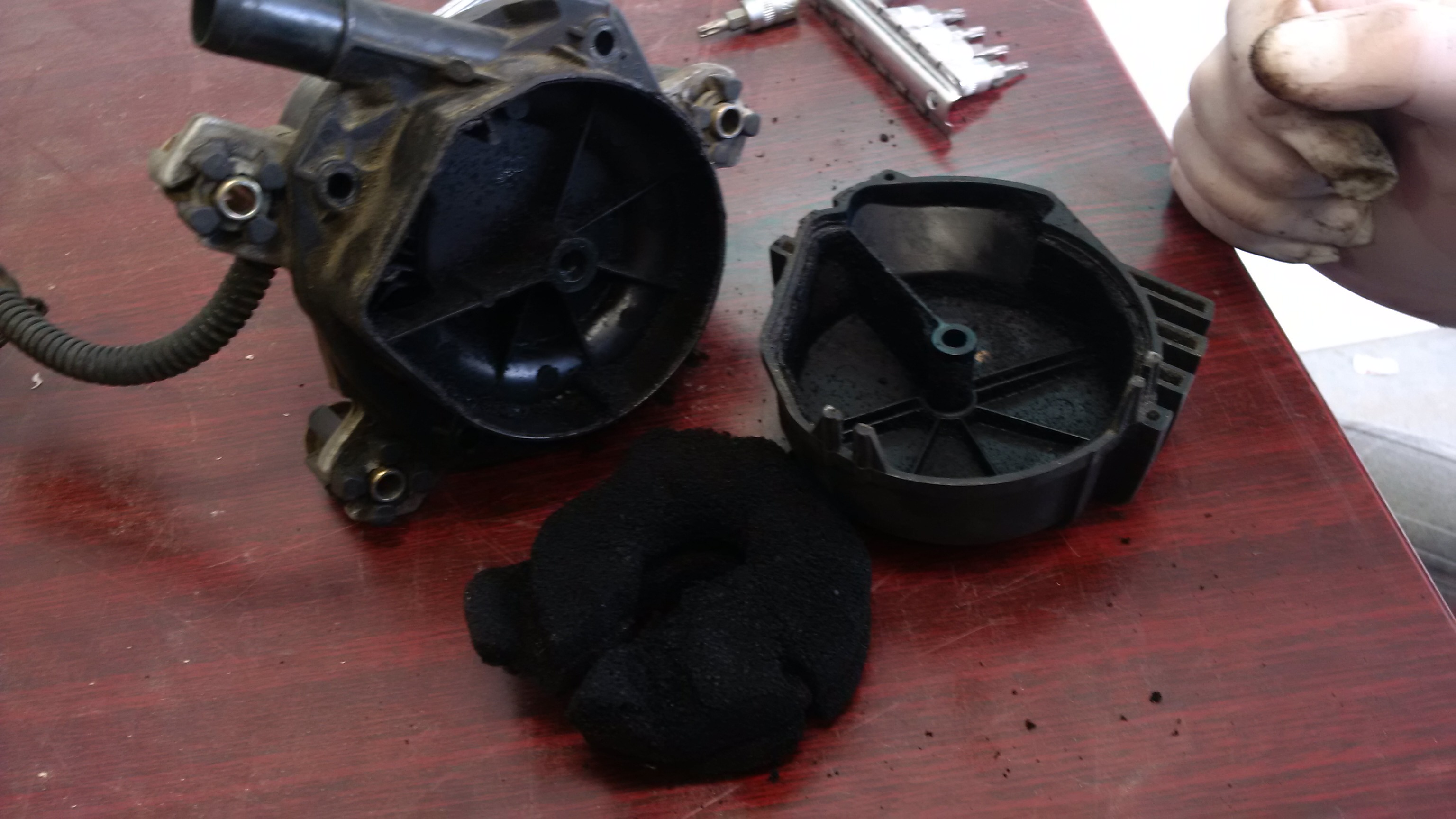

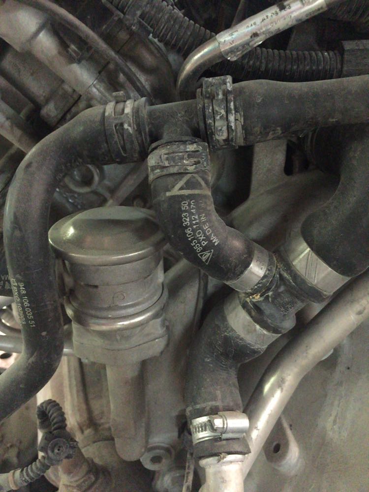

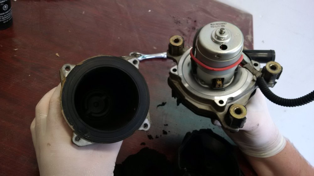

I stripped both mine apart and found to be full of soot because the check valve (see pic 1) from the exhaust connection was stuck open. I used a 3/4" metal GI end plug to close the rubber pipe and problem solved from leak. The fins inside will be broken and that's the cause of the code also if the motor is jammed or toasted the fuse will pop also. Pic 2 foam filter is like a lump of charcoal inside is toast.

Both of mine didn't work and it made absolutely no difference. To be honest if there is no effect and considering the purpose is for warming up the cats a bit quicker, then I wouldn't worry about it. Unless you want to spend some dollar that is and probably one or both pumps are knackered. Motors just burn out, or get seized or the impellor smashes apart and dumps into the pierberg check valve shown in my first picture. Also codes can mean the air flow from that pump is not sufficient, this could be blockage or simply doesn't run.
