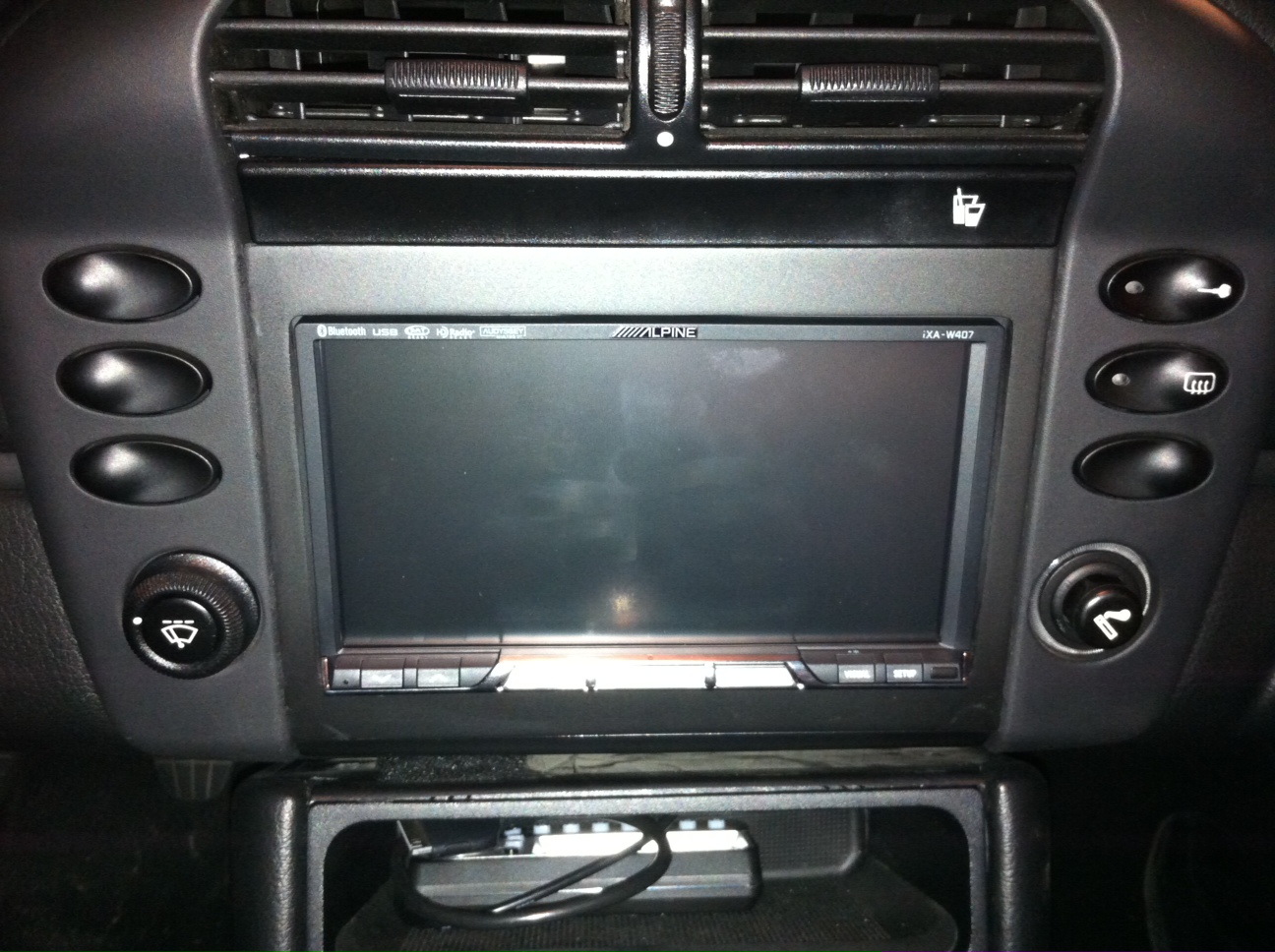

I had two shelves for awhile and it was much better looking (and functional for sunglasses/phone etc...)than having the outdated looing cd holder. Eventually I moved the a/c controls to the lower shelf location and put in a 7" display in where the radio and a/c used to be.
Moving that panel looks like a PITA. However, what unit did you add in?
Actually, moving the A/C controls to the bottom was really easy, mostly a few screws and then unplug wires, reroute lower and replug. That said, prob no need to move it until/unless you wanted to replace the radio. I put in the Alpine IXA-W407 b/c I wanted iPod/iPhone and bluetooth integration (works great except for callers on other end hear some echo because Alpine and iPhone both have noise cancellation and they conflict. (the only PITA on this part was installing a new amp b/c of the MOST fiber optic. Actual amp install was straight forward, more the cost of buying an amp when all I really wanted was an integrated do all head unit)post-59058-0-65972500-1300738930_thumb.j

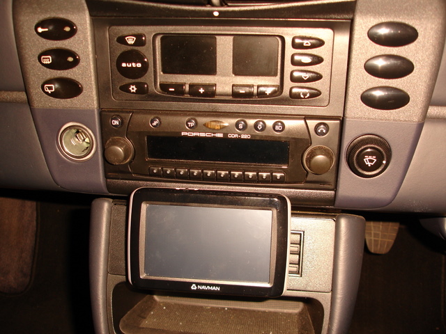

This is a very simple modification but it works well, I left the CD holders in place, bought a length of 90 degree plastic moulding from the local hardware shop, added some velcro and some door draft tape and it slips in between the CD shelf and the radio housing above. Some velcro on the back of my GPS and thats it. If you want more photos of the bracket let me know.

FWIW. I did a similar mounting but replaced the CD trays with an open storage cabinet first. And then wired the GPS audio and power into the back of the Becker head unit.
The GPS comes on with the car stereo. Using a large flash card I now have all of my media in the car at the touch of a button and my mobile phone works through the car speakers using Bluetooth.
Very easy modification and works better then I had expected.
