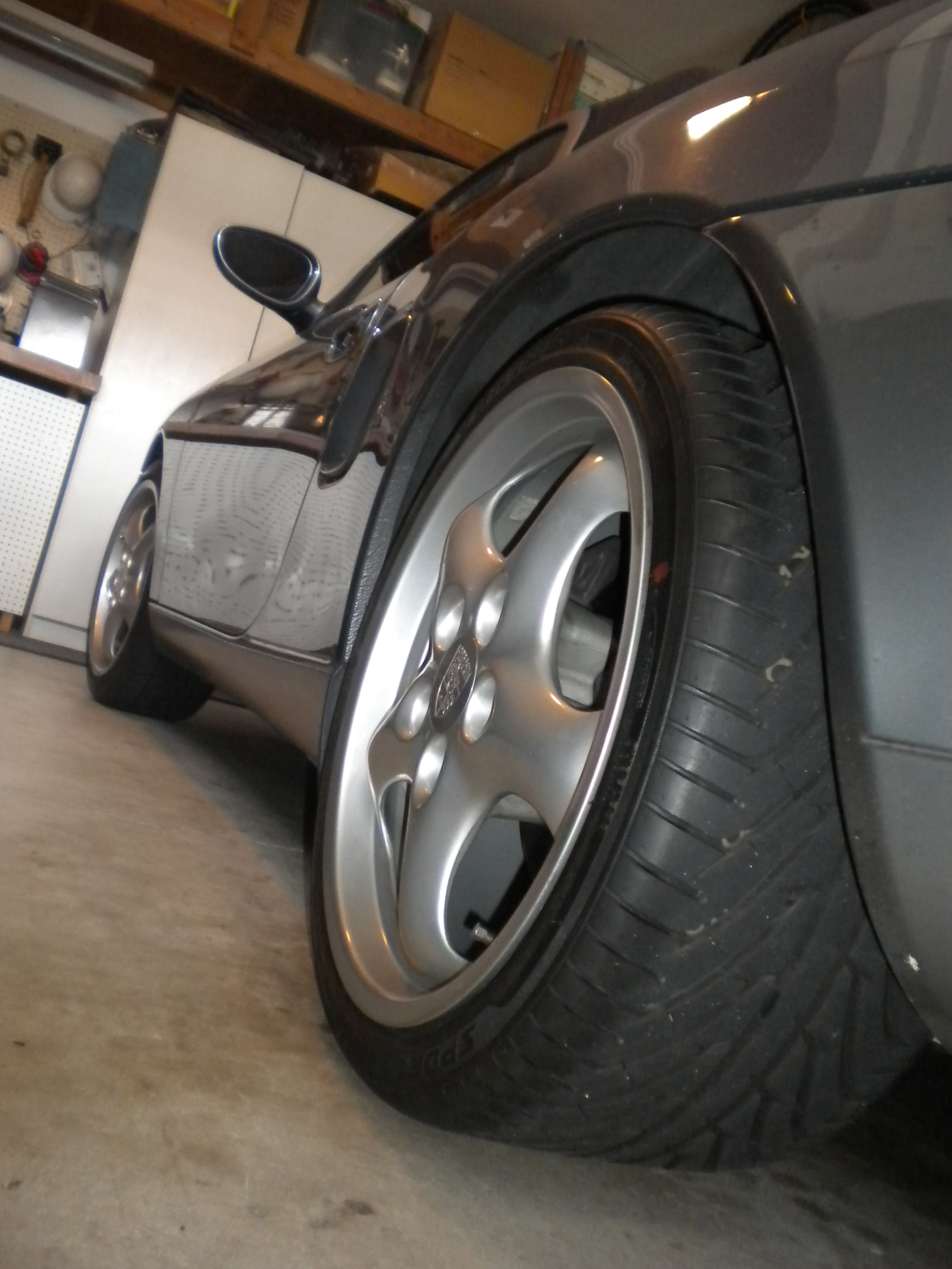

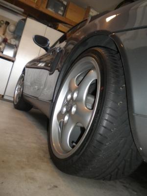

The offsets look close enough. Here's mine and they fit fine:
Fronts: 19x8.5 with 225/35-19 Toyo Proxess-4 (50 mm offset)
Rears: . 19x10 with 265/30-19 Toyo Proxess-4 (47 mm offset)
