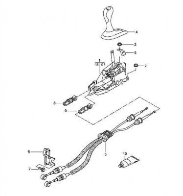

Does anyone have access to a shop manual or a link to a Porsche 996/986 6-speed schematic with part numbers? I can't get my 99 C4 into reverse because a white "L-shaped" plastic piece on the left side of shifter that engages the reverse gear has completely disintegrated...need that part number! Cheers!
Do you see it here?:
post-6627-0-81230900-1301027103_thumb.jp
Regards, Maurice.
I've never seen that part sold separately.
Likely some used ones out there or just order the 997 factory short shifter assembly. You get the whole thing.
