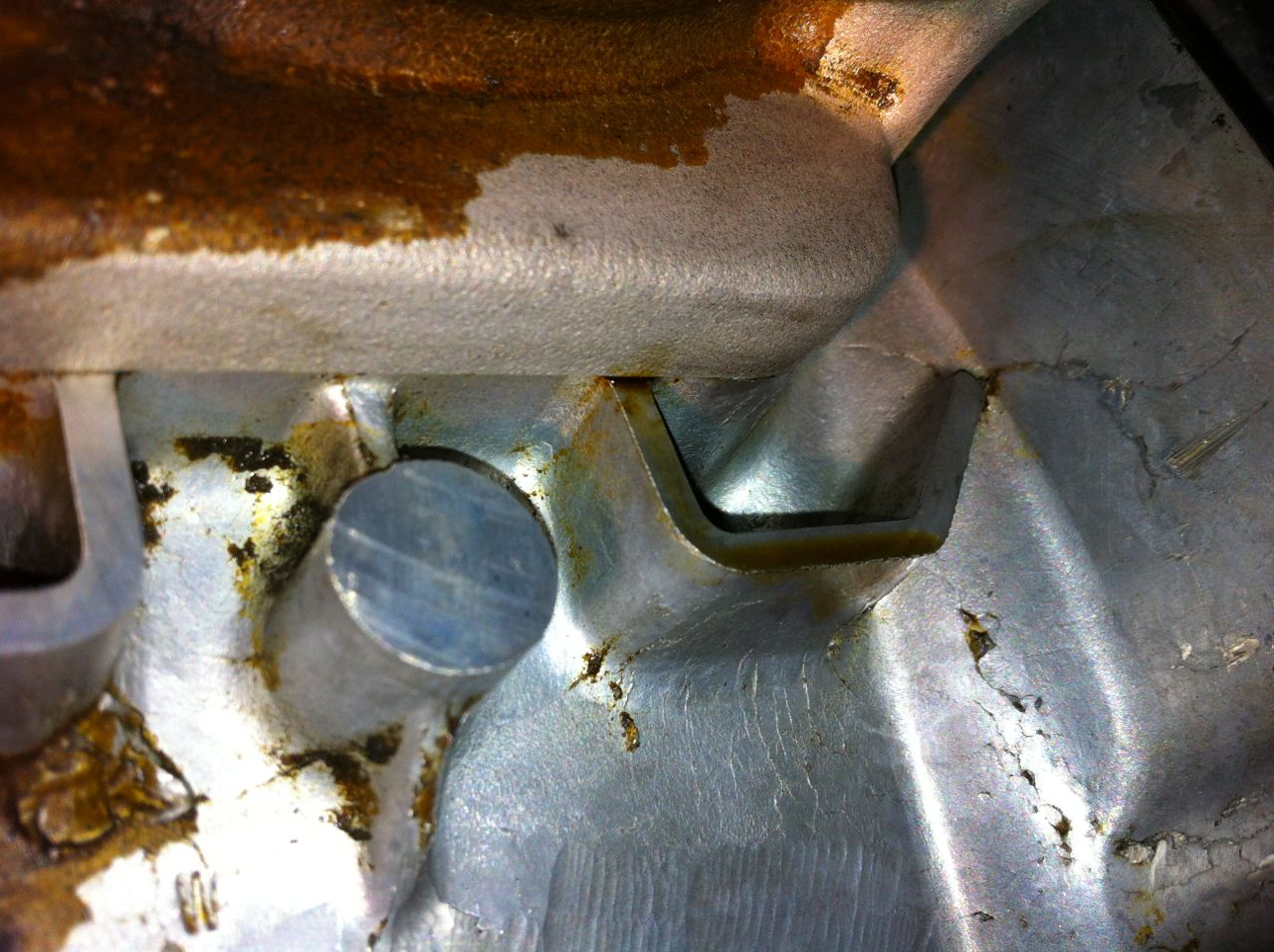

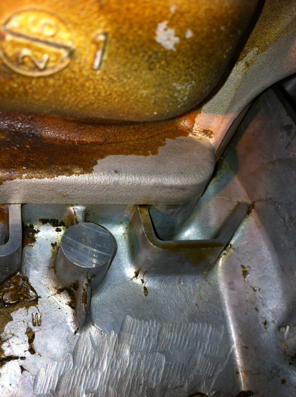

Found a new issue recently, started with an apparent drop in oil pressure (I was not driving, engine went out, oil pressure warning on). Since the 120'000km maintanance the car ran very smootly and used very little oil. I've driven 5000km since and it has used up about half a liter. Earlier it was 1 liter per 3000km.
Now I noticed that a bit of oil is coming out beween the gasket and the seal on the right side. The left side is completely dry. Please have a look at the pictures, anything to worry about?

As to the little bit of oil on your finger, I wish mine was so clean. Its an engine, they leak a little bit. A leak becomes a problem when it drips, what you are showing from the picture is merely a weep. IMO dont worry.
If the head gaskit had blown normally, the oil would be in your coolant or would be getting into the cylinders so it would smoke!!

Thanks for the support guys! That's the problem...my boss was driving in rush hour for the first time with my car all excited so he cannot clearly say how it happened. According to him in stop and go traffic the engine went out and at the same time the warning sign in the dash for oil pressure came on. He checked underneath the car for oil and smell and started again and went off. Since then no issue.
Porsche checked, no oil in the coolant, stable to -30 degrees. Oil consumtion normal, oil level fine, no drops on the floor when I park the car.

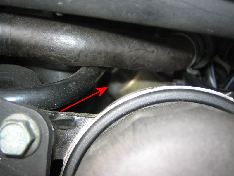

Many TT owners had this problem of "intermittent oil pressure warning signal" and the only fix is to replace the sender. I don't know if Porsche came out with an upgrade but there is a supersede part# and it is 99660620302. The cost of this part is $72.00. To replace it it is a bit tight but can be done....I agree with Frank don't be too worried about little oil on your engine. No puddle under the car, no presence of oil in the coolant or coolant in oil, you should be good....
