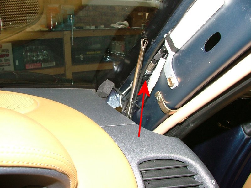

I think this is par for the course, that's why I added an iPod. The antenna booster is in the right side "A" pillar (at least it is for left-hand drive cars). I examined mine and cleaned the ground but there was no noticeable difference.
Same place on a RHD car:
post-4000-0-03286500-1302594242_thumb.jp
Sometimes, cleaning up and/or improving the ground at the bolt directly to the right of the arrow in Richard's photo will improve reception and/or reduce static.
Unscrew that bolt, clean off any surface corrosion and coat the area with some dielectric grease to see if the situation improves.

Bringing up this old topic again, how do you remove the trim to expose whats in the picture?
Thanks in advance
Jonathan
1. Remove the sun visor. It simply pulls out
2. Use the small flat screw driver to pry of plastic cover on visor base. When removed, you will see the Hex bolt heads
3. Use the 4 mm Hex wrench key to remove both bolts. Hold on to the part, it has washers on the other side and can get fall off if not careful.
4. Now pull off the A-pillar cover to reveal the cables underneath.
Just to note on step 4, the a-pillar cover simply snaps out, and does require a little force if I remember right. There are some plastic or metal compression rivets that snap the cover into place on the frame into the oval holes on the a-pillar frame in the picture above.
