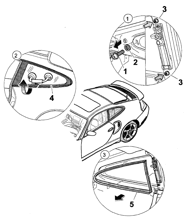

Remove B and C pillars inside the car.
Unscrew the fastening screw 1 and remove the washer 2.
Unscrew fastening nuts 3.
Pull out side windows 4 downward in the direction of arrow.
Pull off rubber seal 5 from the rim of the side window section.
