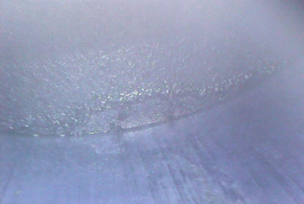

OK so the feedback from the Porsche service centre is that cyl no 3 is scored...very bad news. Their suggestion is new engine needed, whether a short or half engine... The price rel to car residual value means this is not a sensible option, unless I can get some contribution from Porsche.. So I need all the ammo I can get. Does anyone know of successful goodwill applications to Porsche (US, UK, EUR) in similar cases (6-7 year old car, 65k miles, owned from new etc..)?

Sorry to hear that. Yes the heavier knocking sounds like what they call piston slap. In my case a bore scope inspection showed scoring in cyl no 3. Scoring shouldn't in itself cause knocking, so more likely there is a tolerance issue or perhaps broken piston or piston ring causing both the knocking and the scoring... From what I can ascertain, Porsche prescribe a new engine block due to all the labour involved in repairing the bore, but it is less clear why one could not replace the offending piston/rings and live with a little scoring..?
