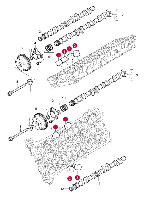

i have rebuilt 7 of theese engines in the last 7 months. there is a definitte problem with cam followers in theese engines, but this is not the main problem with the engines. The cylender walls become scuffed by poor quality pistons from factory. I have as mentioned have rebuilt severall of theese engines with no problems, with much less cost than Porsche,,, 10 grand our end...20 or more from Porsche
o, tappets. got it. so what could go wrong with them so that they can start making knocking noise? I am now going to ask a very stupid question. Idle RPM is 560-600 so 10 piston movements/second. so how could it be a scored cilinder if the knocking sound that I have (and most other people with similar problem) is at much lower rate 120-180/minute or thereabouts. what could it possibly be? my knocking is in the area of cyl 5-6 (i have 4.8 Turbo)

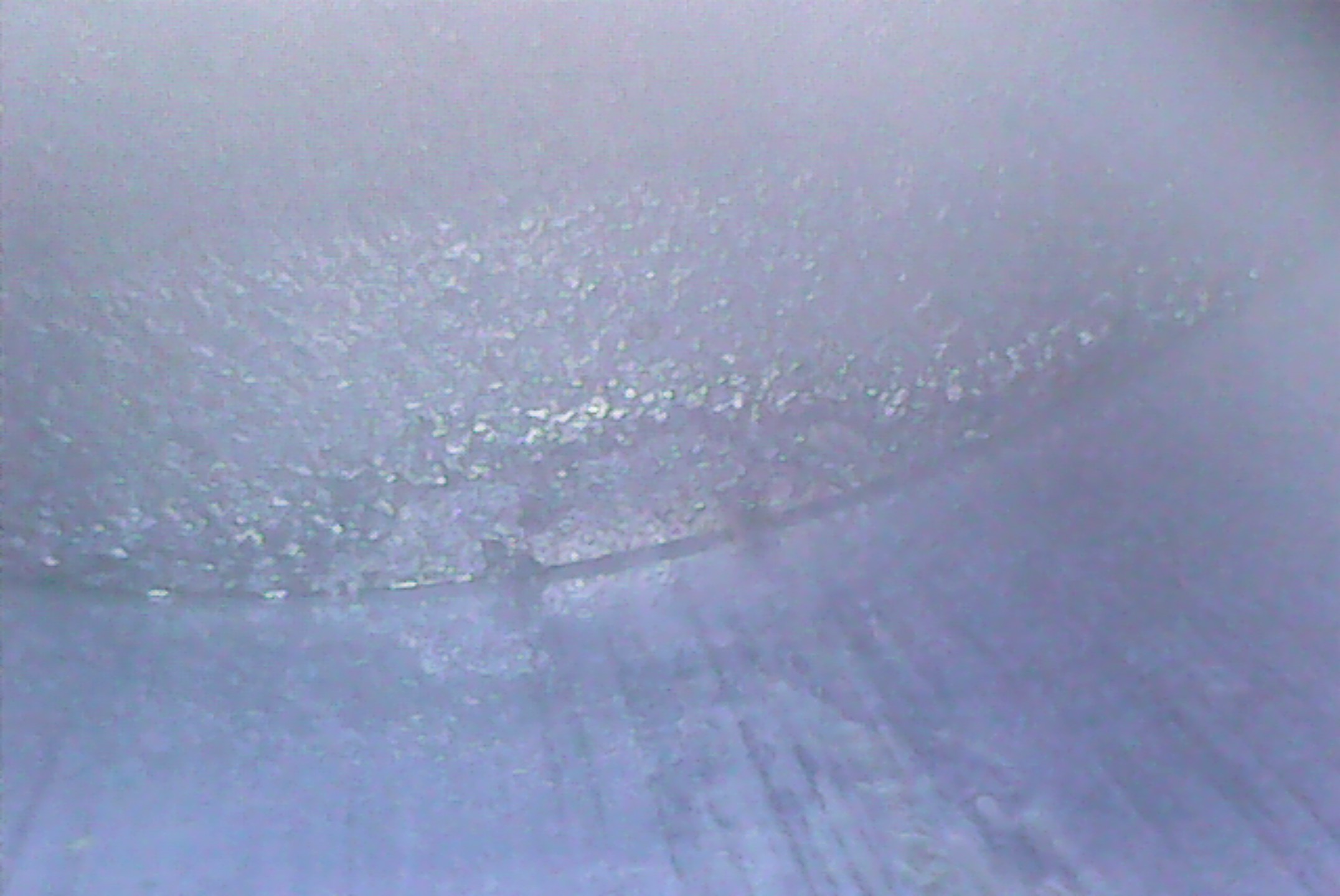

Here too looking for any repair info on this issue.
I just bought an 08 Cayenne from an indy dealer -As is No Warranty - They wouldn't offer one.
Engine ran fine on test drive of about 10 miles - no problems evident anywhere - vehicle looks factory fresh from top to bottom.
Drove about 65 miles home with only one large puff of blue smoke on launch from light- ran fine save a slight miss at times.
Next day changed oil Mobil 1 0w40 with Mahle filter and vehicle close inspection - looks better than suspected everywhere.
Following day drove around town 20 miles or so low RPMs and city traffic developed a serious miss and performance issues.
Checked and replaced coils (BERU) and plugs (Bosch) before extended drive following day - after 60 miles developed same miss and heavy oil consumption (#8 & #1 cyls.). Parked it and boroscoped  Cylinder 8 and found scoring from photo attached. also only 150 psi compression on 3rd hit.
Looking for an effective solution short of total engine replacement. Anyone have luck with re-honing cyls and re ring engines here?
Welcome to RennTech :welcomeani:
Unfortunately, you are not going to be able to hone out that amount of liner damage, and even if you could, the pistons would be so loose in the bores you would have even larger issues.

Feel very sorry to hear this. Very bad luck.
wondering you didn’t hear anything during test drive. Surprised it happens so suddenly. No extreme driving, no extreme driving.
Maybe they have used a extremely heavy oil to push down the knocking noise when u had your test drive.
which engine is it? How many miles?
