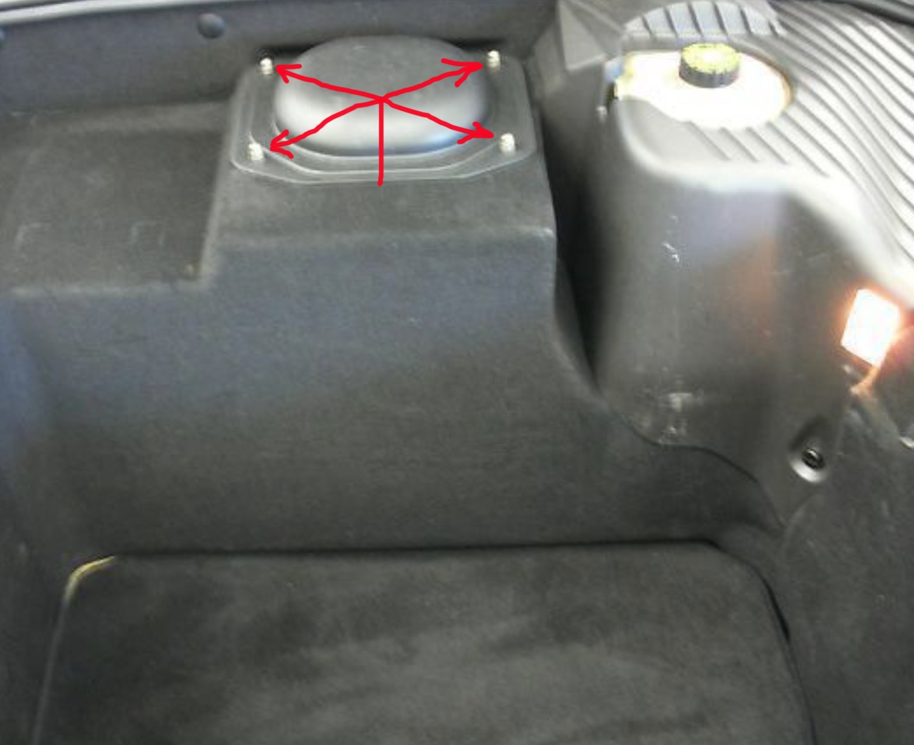

I was thinking about your fault. If the gas cap can be part of the problem because the tank vacuum for vapor recirculation did not work....The fuel cap being new, how about the main cap on the reservoir itself. May be it is loose. Very easy to found out , four nuts... Are we looking at the impossibility to create negative pressure inside the reservoir? I think so....

It's a good thought, but it didn't leak any smoke when I put smoke into the gas tank. I figure if there were a leak it would have manifested itself with the smoke.
Regardless, I'll take another look. It doesn't take long to remove the fittings and the ring.

The main cap on the top of the tank is tight.
