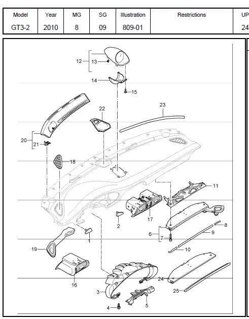

Looks like it pries out. You can always buy
a new one from sunset imports. Then
you will learn where to pry. Here is a picture.

1. With a screwdriver through the top air slot, release the retaining clips A and pull the air vent out of the dashboard.
2. Pull apart the electrical plug connection and remove the air vent.
Install is the reverse.

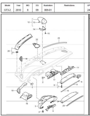

Thank you Paul and Loren. It is part 18 so still in the dark but have ordered a new cover. Any other ideas? Many thanks John
Piece #18 is just held in by compression w/ 4 small tabs on part itself: 2 on the long side of triangle, one on each shorter side. Use some plastic trim removal tools or a butter knife covered w/ electrical tape (to not mar the dash) and gently pry it up using the corner nearest A pillar (part is about 3/4" deep FWIW). Then, pick up some very thin self adhesive felt (from Lowe's / HD or a craft store like JoAnns/Michaels) to line it with and put it back in place.
