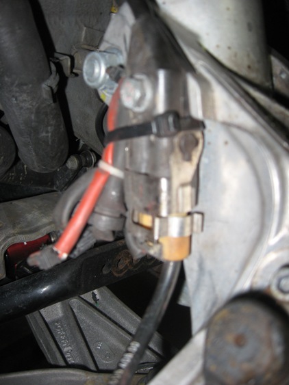

There is a connector mounted on the side of the wheel carrier. In this not-so-great-picture, you can sort of see what I am talking about. The speed sensor and wear sensor plug into this. (In this picture, the wear sensor wire is coiled and wire-tied off - this is a dedicated track car, and I don't use the sensor.)
Is the wire split above this connector, or below? If below, you can buy a replacement and just plug it in.

Most likely, you are in for a "bone yard search" if the connector you broke is on the wiring up from the removable brake pigtail; only the very early cars had a disconnect point in the trunk area, yours probably does not. This is not a big project, but finding the connector will definitely be an "Easter Egg Hunt"........
