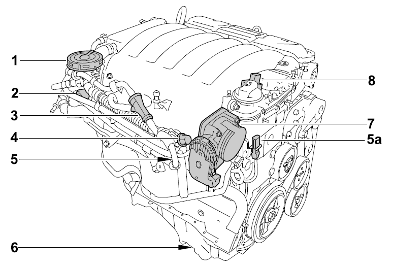

Originally you asked about V6... I am confused. Do you want V6 or V8?
Item number 1 in Lorens pic is a crankcase breather valve. The EVAP control valve is located at the rear of the intake manifold and is part number 955 605 517 00. The fault code P0441 is for a EVAP fault which is often a fault in the control valve not the breather valve.
