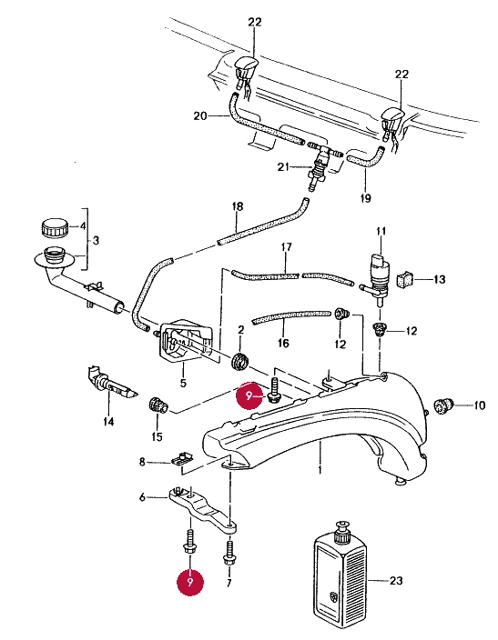

Hi: Ive got a leak near the reservoir in my 996 w/ Litronic lights & spritzers. Removed inner wheel well. Leak seemed to be coming from the tank. CI Can't figure-out how to remove the Tank(reservoir).I've looked for answers on the web & on my Maint CD to no avail.Thanks

If I remember right, three might (or might not be) be one easily accessible bolt on the top, then the thank just pulls out towards the front of the car. It's held in place with grommets from behind (near drivers door) and is just a compression fitting with plastic forms on the tank. No bolts or anything. Just use some brute strength or if you can fit a small pry bar behind.
Be careful though, if there is fluid in the tank it can easily spill out once you remove it.

This may help. http://www.renntech....__fromsearch__1 Although I don't have the light washers on mine.
