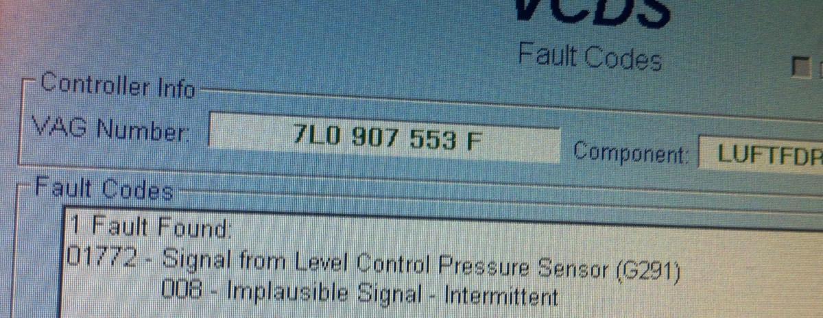

I have a 2004 CTT with about 65K miles, so far been pretty bullet proof. I just started getting a warning light on my dash that things are amiss with the air suspension. The warning light goes on about 30% and it happens about 10/15 minutes into a trip. I cannot fell any difference in the car when driving. When I turn the car off/on, the warning light goes out.
I pugged in my Durametric last night and got a code 1772. Does anyone have any idea what the problem is and if so is it something that I can fix myself or does it require me to take it to a pro to fix.
Thanks in advance - Steve

Fault code 1772 -- Pressure sensor signal wire
Possible cause of fault
- Short circuit to B+ in the wiring of pin 84 of the level control module
- Short circuit to ground in the wiring of pin 84 of the level control module
- Open circuit in the wiring of pin 84 of the level control module
- Level control module receives implausible signal from pressure sensor
- Pressure sensor faulty
- Level control module faulty
I would reset it and see if it comes back. If so inspect the wiring.

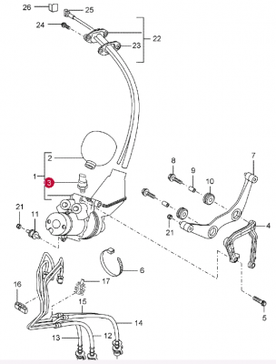

Now my question is, is the Pressure sensor in the Valve Block/Solenoid or the Compressor? From what I have gathered, it is in the Valve Block/Solenoid, which means I have to change this. However, if it is in the Compressor, then I would need to change the Compressor instead. Both are pretty pricey, so it is important to get the right one.
Any guidance?
Share this post
Item 3 is the presssure sensor...

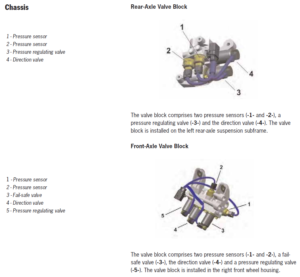

I don't think so - your car (2007 and newer) has PDCC. So you have two blocks

I think we're referring to Level (Height) Control instead of PDCC anti-roll system?
