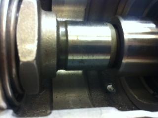

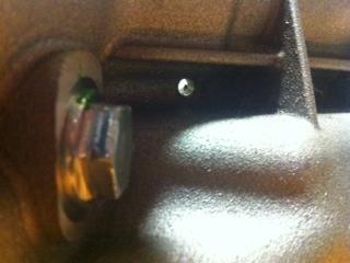

The tech looked at it this morning and found a hole on the front diff about 5mm wide and 1 to 2 inches below the fill bolt. We are thinking this is a weep hole by why is it below the fill plug and why would it leak? Is something missing?
Here are pictures taken of a cut-away diff that show the location of my leak.

Just a follow up for anyone interested. A leak from this particular weep hole (there are two on the front diff) indicates a leak at one of the internal seals. Porsche does not offer parts to fix it. Instead, the entire differential has to be replaced. The differential is $6000 and the labor is estimated at around $900. My car is 7 months out of warranty but its been leaking for a coule of years according to the service documentation from the previous owner. The car is currently at the dealer waiting for the leak to be inspected again. We'll see if Porsche will honor some sort of warranty on this since it was problematic before the warranty expired.

This additional info was just emailed to me by a Porsche tech...
There are two separate chambers in the front diff of your Turbo. Both are separated by a chamber that only houses a bearing. On either side of the bearing are seals. If there is a seal leak, the weep hole is there to protect from fluid cross-contamination. Both chambers have different fluids. There are two weep holes. The one were talking about and the one on the bottom side of the diff. One is repairable and one is not, yours is not and must be replaced.

Beanster, Where did you get the picture of the cutaway diff? Do you have a long shot of the weep holes on the diff? I can't get orientated with the close ups. Thanks
The tech from the dealership where this car originated has been very helpful. He was the first to find this leak back in 2009 (though no fix was applied). It just so happened that he was at a tech class when I emailed him about the continued leaking problem and luckily Porsche had a cut away differential there at the class so he snapped those pictures for me.
