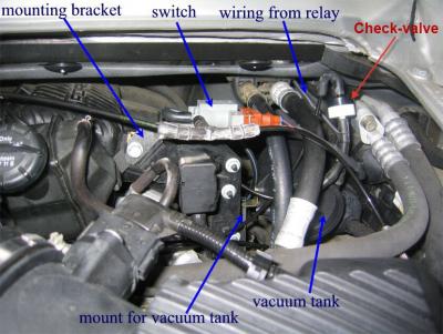

Double check your wiring and make sure you didn't put the check valve in backwards.

No the check-valve is in the vacuum line (usually a black/white disk) - if installed backwards then the system will work backwards.

The black/white check-valve looks to be from a older model.
Does anyone have a PSE installed in their 2007 997 cabriolet and can take a picture so i can try to figure it out.
Or does anyone else know how else to resolve this problem. Everything is working but in reverse order.
