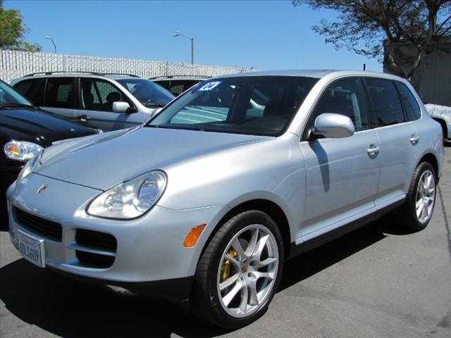

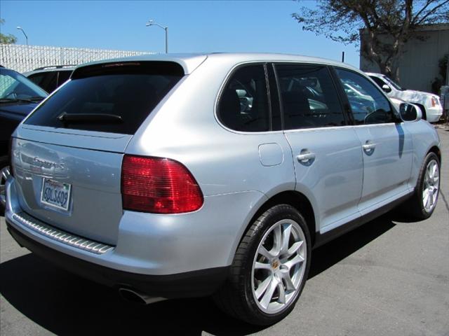

Picking up my 04 Cayenne S tonight...
Any feedback would be appreciated, but hopefully just happy comments :cheers:
69k miles with 60k maintenance done.
I also had the dealer service brakes and replace pads (has Brembo turbo brakes) and replace 4 tires (21" wheels) with new performance Conti's.
Have a 3yr/36k mile warranty with $50 deductible.
I know my insurance is slightly higher, and gas mileage slightly lower but one my true concerns... maintenance.
I've done a lot of research on the subject and if maintained and stick to minor/major services (albeit not cheap), the cost isn't outrageous - I can stomach $400-500 if I am planning on it.
With that said, what about out-of-the-blue problems? Happen sparingly? Pretty fair from that end? I have only owned German cars, mainly Audis, one BMW - they aren't Honda Civics but the less 'surprises' the happier I'll be... Last but not least, some have mentioned oil change and filter every 20k miles; there is no way it's that infrequent, your thoughts?
Thanks!
